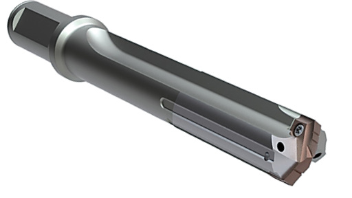

For a new development in reaming options, Komet offers indexable-insert reamers, starting at 45mm in diameter. The insert set is ground specific to the body. The inserts can be indexed once by the end user and the tool can be used again immediately. The precision necessary for reaming requires that all inserts be indexed at the same time even if only one blade is damaged. When new cutting edges are needed, the body is sent back to Komet where a new set of inserts is ground.
In addition to these various multiple-edge reamers, single-blade reamers with guide pads are available. With these tools, the user can adjust the diameter relative to the guide pads on the reamer to hold tight tolerances and achieve fine surface finishes.
