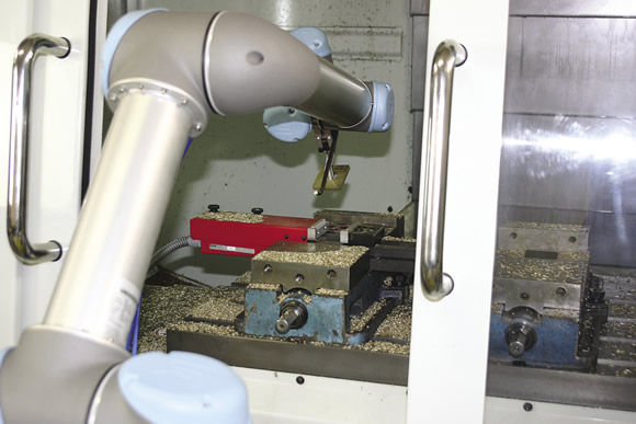

Above: The UR5 robot arm places a workpiece into an electric vise.
The majority of the robot programming involves manual motion recordings, such as moving it from the workpiece pallet to the workholder to the machine door to the cycle start button and starting and stopping the record function for each segment. “The greatest thing is the ability to record the movement,” Escalette said. “You get 80 to 90 percent of your programming done with just a simple series of recordings, and then you just fine-tune it with the keypad.”
The hand-held, touch-screen keypad, or tablet interface, provides significant benefits, according to Shane Strange, the parts manufacturer’s automation and integration specialist. “You’re right there with the robot, troubleshooting as you go. It saves a lot of time when you don’t have to go back to the office, run simulations, go back on the floor, boot it up and watch in real time what it’s going to look like,” Strange said, noting that he performs all those actions with the keypad. “If you can write a to-do list, you can program this robot.”
In addition to easy programming, the robot arm provides flexibility. For example, the company uses the UR5 to bend 1,500 parts on a tube bender in 4 hours, which otherwise takes 3 days using manual labor. That flexibility is enhanced because the robot can operate without safety shielding as long as the end-of-arm tooling isn’t carrying something that can injure a worker. If a worker does contact the robot arm and a force of at least 150 newtons is exerted, the arm automatically stops operating.”In a flexible environment like ours, you need a flexible robot,” Escalette said, “one that can work without safety cages, is portable and can be reprogrammed quickly.”
The robot can be moved on a dolly or by sliding it, Escalette said. The company uses dowel pins in front of a machine to indicate where the robot needs to be positioned. After removing the pins, two bolts secure the robot. “It doesn’t have to be super rigid and doesn’t need to run very fast with a lot of torque because the movements are all predicated on the cycle time,” Escalette said. “If we have a 2-minute cycle time, the robot is sitting most of the time anyway.”
