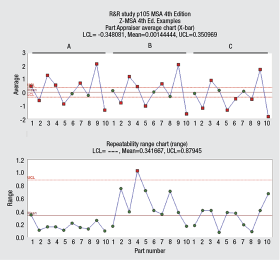

Preparation is critical to the validity of a GR&R study. It can be easy to head down the wrong path at the onset and become bewildered by confusing data at the end of the process. And, a study can take a long time. Some studies may begin weeks before the first measurement is taken.
A random selection of parts must be gathered ahead of time. It’s important to have a good spread of the natural process variation. Simply grabbing the last 10 parts off the production line could lead to a poor R&R percentage because of how the results are calculated.
Sample of a part appraiser chart (top) and a repeatability range chart.
When conducting a GR&R study, users of the gage being studied should also be the appraisers. Parts should be measured in a random order, and the results should be concealed from the appraisers to prevent one appraiser from influencing another’s measurements. Also, the environment where the GR&R study is conducted should be the same as where measurements are normally taken, or as close to it as possible so as to avoid introducing new elements of variation.
After measurements have been gathered, calculations can be performed using one of several approaches, such as the measurement system analysis (MSA) method from the Automotive Industry Action Group, the ANOVA (analysis of variance) method or the EMP III (evaluating the measurement process) method.
As mentioned earlier, all the calculations yield an R&R percentage, but each can provide additional details about the source of variation in the measurement system. After finding a method that works well and meets auditing requirements, it is important to use the same one for subsequent GR&R studies.
No matter which calculation method an organization employs, software can streamline the calculation process. GR&R studies are like forms to be filled out, which means the data can be calculated automatically. This is a better method than performing calculations manually, which is not only time consuming but also increases the risk of error. Calculating at least one study by hand helps you understand how the results are computed, but, after that, let a program churn out the results. Numerous software programs are available.
