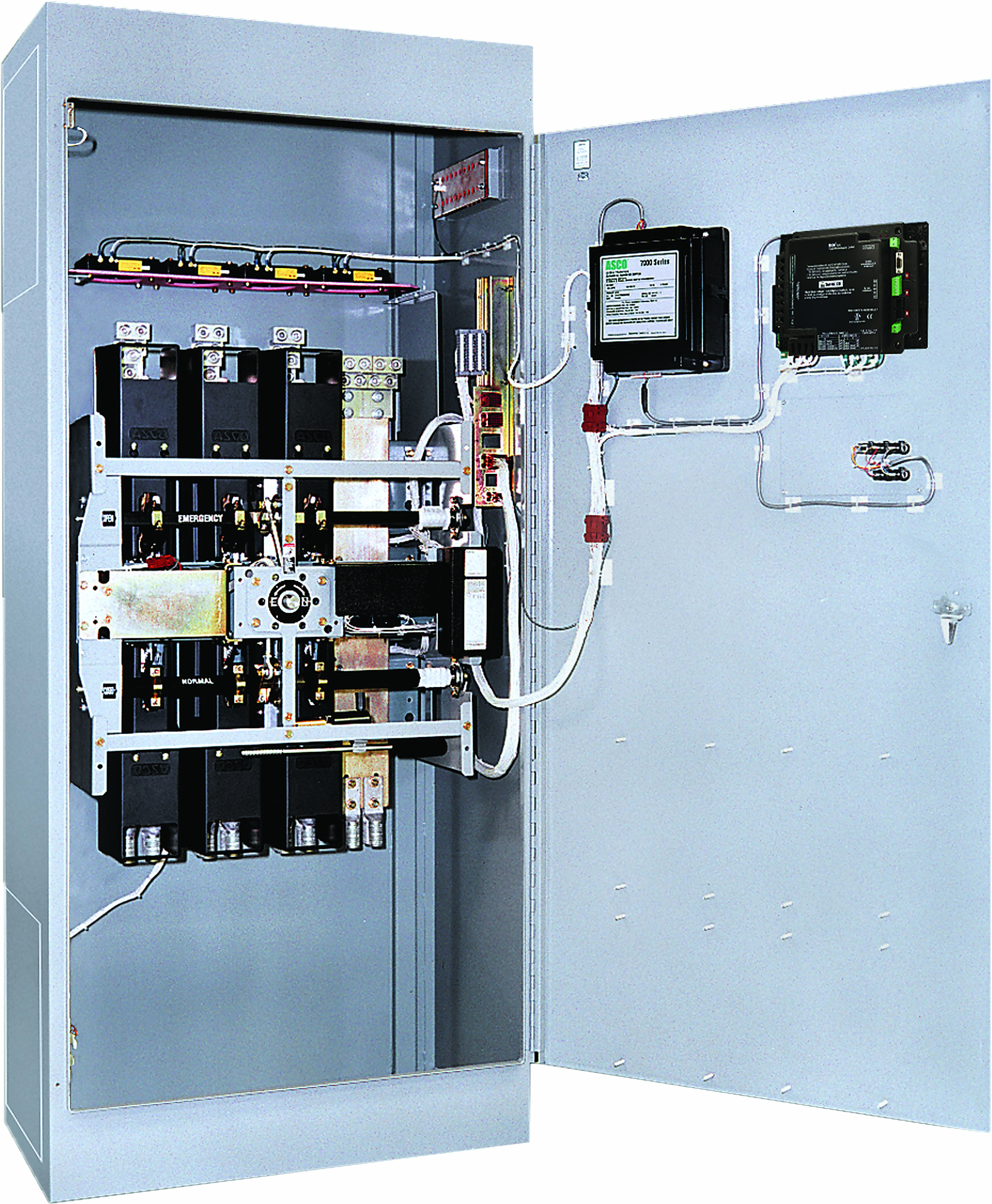

ASCO Power Technologies manufactures automatic transfer switches, switchgear and other power management products. Image courtesy of JetCAM International
