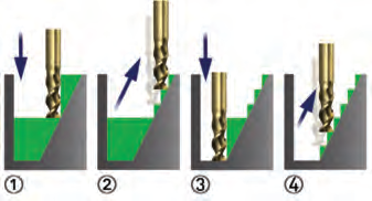

Mastercam X5’s OptiRough approach drives the tool to the full flute depth and uses the Dynamic Mill algorithm to machine the largest possible conical area. Once the tool roughs this area, it proceeds to step up in a series of small increments and machine the material remaining on the sides at each interval.

In 2009, Mastercam X developer CNC Software Inc. introduced the Dynamic Mill algorithm for 2-D pocketing within areas bounded by straight, 90° walls. Unlike conventional roughing that zigzags across the material while deeply engaging only the tip of the flute, Dynamic Mill can apply the entire flute length at a high spindle speed and feed but with tiny step-overs.
The toolpath protects the tool and machine by monitoring the condition of the material at every stage of the machining process and adjusting the toolpath according to what is ahead, as well as adjusting the feeds and speeds for air moves to continuously keep tool load constant and within safe limits. These toolpaths tend to be smoother and more continuous. Using this approach, alternate tool motion, such as trachoids, becomes less necessary to reduce tool loads.
With the release of Mastercam X5 in 2010, Dynamic Mill was expanded to allow 3-D, full-flute roughing of areas with slanted walls. This OptiRough approach drives the tool to the full flute depth and uses Dynamic Mill to machine the largest possible conical area. Once this area has been roughed, the tool proceeds to step up in a series of small increments and machine the material remaining on the sides at each interval. By stepping up instead of stepping down, the tool engages as much of the flute as possible at each Z-axis interval.
Lab trials and user reports confirmed that this full-flute approach reduces roughing cycle times 10 to 70 percent. With self-aware, full-flute roughing, the spindle travels shorter distances to perform the same amount of work. In one case, 45,000 linear inches of travel to rough a part with conventional approaches was reduced to 16,000 linear inches. In combination with reduced tool load, this approach reduces machine wear.
