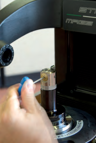

The Speroni Magis presetter’s edge detector feature allows an operator to “dial in” boring heads to specific diameters because the crosshairs move with the tool’s image.

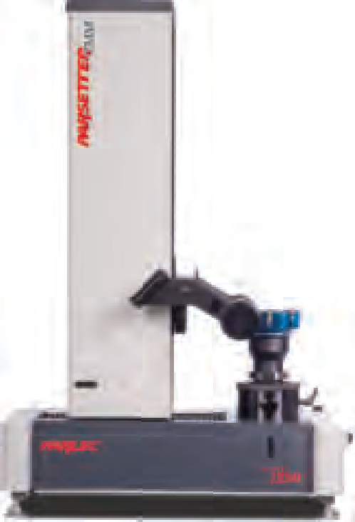

Courtesy of Parlec
Parlec’s TMM1550 benchtop presetter can be used for basic tool measurement and advanced tool management applications.

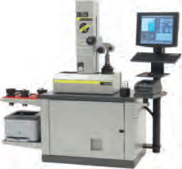

Courtesy of Zoller
Zoller smile is an entry-level presetter for shops with a small number of tool changes. On this CNC model, standard parameters are measured automatically—length, diameter, radius and two angles.

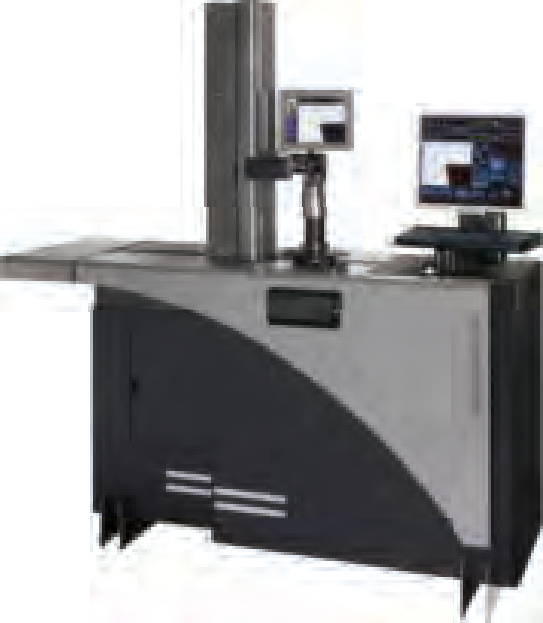

Courtesy of Koma Precision
The Elbo Controlli Amon Ra presetter converts tool data into CNC code for direct loading into the machine control and imports/exports DXF CAD profiles for comparison on a twin-screen camera.
