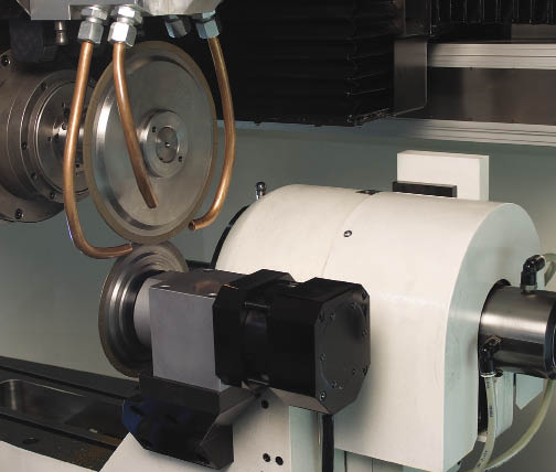

Online truing and dressing of diamond wheels with CNC rotary diamond dressing tools is particularly effective when grinding difficult-to-machine workpieces.

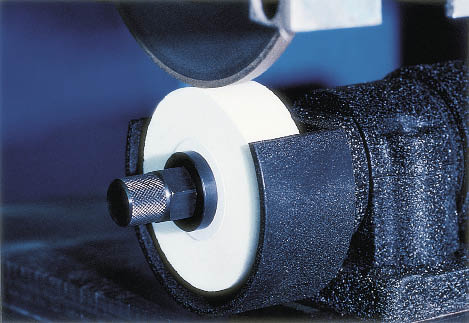

Figure 3: A brake-controlled truing device (BCTD).

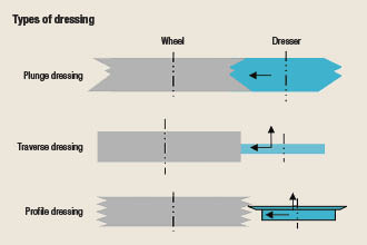

Figure 4: Types of truing/dressing.
The first method is the most common for truing diamond wheels smaller than 12 ” in diameter. The wheel is removed from the machine spindle and trued on another machine. Either a universal grinder or a machine dedicated to offline truing may be used. A SiC or Al2O3 truing wheel is turned at a periphery speed approximately five times faster than the periphery speed of the diamond grinding wheel. The truing wheel, which has grains larger than that of the diamond wheel, is moved across the face of the diamond wheel at a traverse rate of 30 to 60 ipm and an infeed of 0.0005 ” to 0.001 ” until the grinding wheel’s TIR is 0.0002 ” or less. This method generates a wheel that is true to the offline machine spindle but may actually have TIR of 0.005 ” or more when mounted back on the grinding spindle. Even in a best-case scenario, the TIR on the grinding spindle may be as much as 0.001 “. Stick dressing may still be necessary with most resin- and metal-bond wheels to ensure optimal grinding conditions.
In the second method, a brake-controlled truing device (BCTD) can be used to true wheels online on manual machines using conventional abrasives (Figure 3). The truing spindle must be oriented parallel to the grinding spindle to ensure a straight face. Cup wheels can also be dressed with a BCTD if the truing spindle is mounted perpendicular to the grinding spindle.
Diamond wheels larger than 12 ” in diameter may take longer to true due to higher truing wheel wear. To compensate, a fixture or arbor may be built to mount a truing wheel 8 ” to 12 ” in diameter in the workpiece position on the machine and rotated against the diamond wheel, effectively transforming the grinder into a truing and dressing device.
Many CNC grinders have powered truing spindles permanently mounted in a position out of the workpiece’s way. At a preset interval, a truing program is invoked that tells the machine to position the grinding wheel to the truing spindle. The machine then compensates for the amount of material removed from the grinding wheel and returns to the grind cycle. The amount of wheel trued away is predictable but will vary depending upon the grinding wheel bond type, grade, grit size and the truing wheel abrasive type, bond grade and grit size.

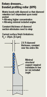

In the third method, wheel truth is achieved by traversing (Figure 4) a diamond bonded profile roller (BPR) or sintered diamond roller across the face of the wheel. Wheel truth is achieved faster as a result of a higher ratio of truing wheel infeed per pass to grinding wheel removed. BPR and sintered rollers having a diamond depth of ¼ ” or more are well suited to this application due to their extended life (Figure 5). Optimizing this process by varying the truing/dressing ratio and overlap ratio permits the machine to return to grinding without the need for additional stick dressing when using vitrified-bond and newer hybrid-bond wheels. Resin-bond and some metal-bond wheels still require stick dressing to condition the wheel face.

Wheels with more complex geometries require a different approach to generate the required geometry on the wheel face. In one method, complex geometries may be formed in diamond wheels by using a single axis to plunge the wheel into a formed diamond truing/dressing tool. A second method using a rotary CNC profile tool is more common when truing and dressing diamond wheels (Figure 4).
When plunge truing/dressing, reverse-plated and infiltrated rotary diamond tools are made with the inverse geometry required on the grinding wheel face. The profile of the grinding wheel is generated by plunging the wheel into the truing/dressing tool. Reverse-plated truing/dressing tools have a single layer of diamond along the profile, which makes them unusable when the diamonds wear beyond the profile tolerance, while infiltrated truing/dressers may be reconditioned to restore the profile.

Figure 5: BPRs have a diamond depth of ¼ ” or more.
You can’t buy a diamond wheel and truing/dressing roll, mount them on a machine and expect to successfully true and dress online. The system requires enough stiffness so that it doesn’t deflect with a wide area of contact. It requires enough truing/dressing spindle torque to avoid stalling. Finally, there should be a simple software function to position the wheel to the diamond roll. A variable-speed and variable-direction truing/dressing spindle enhances the ability to adjust parameters to optimize the process.

A second process using diamond wheels was also evaluated. An ANCA RX7 grinder was retrofitted with a MaxTorq rotary dressing spindle and a BPR diamond profile roll to true/dress a Norton vitrified-bond diamond wheel online. The wheel was mounted and trued online and the part ground with one pass per slot. The truing and dressing was done counterdirectional at a traverse depth of 0.0002 “, a -3.5:1 speed ratio and a 5.3:1 overlap ratio. As a result, the cycle time to grind slots in one part was 20 minutes, the cycle time to retrue the wheel was 10 minutes and the total time per part was 30 minutes. Abrasive cost per part is now near 50 cents.
Compared to the first method, the second method saved 7.5 hours per part; reduced tooling cost by $15.50 per part and reduced total cost by 96 percent.
