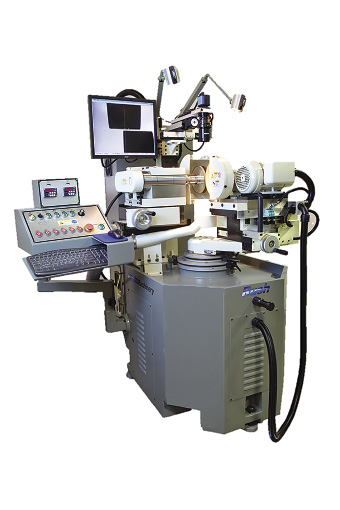

Rush 3.Model 252 Sharpens Drill.tif
Courtesy of Rush Machinery
A Rush Model 252 drill and tool grinder grinds the point on a 1¼ “-dia. HSS twist drill.
