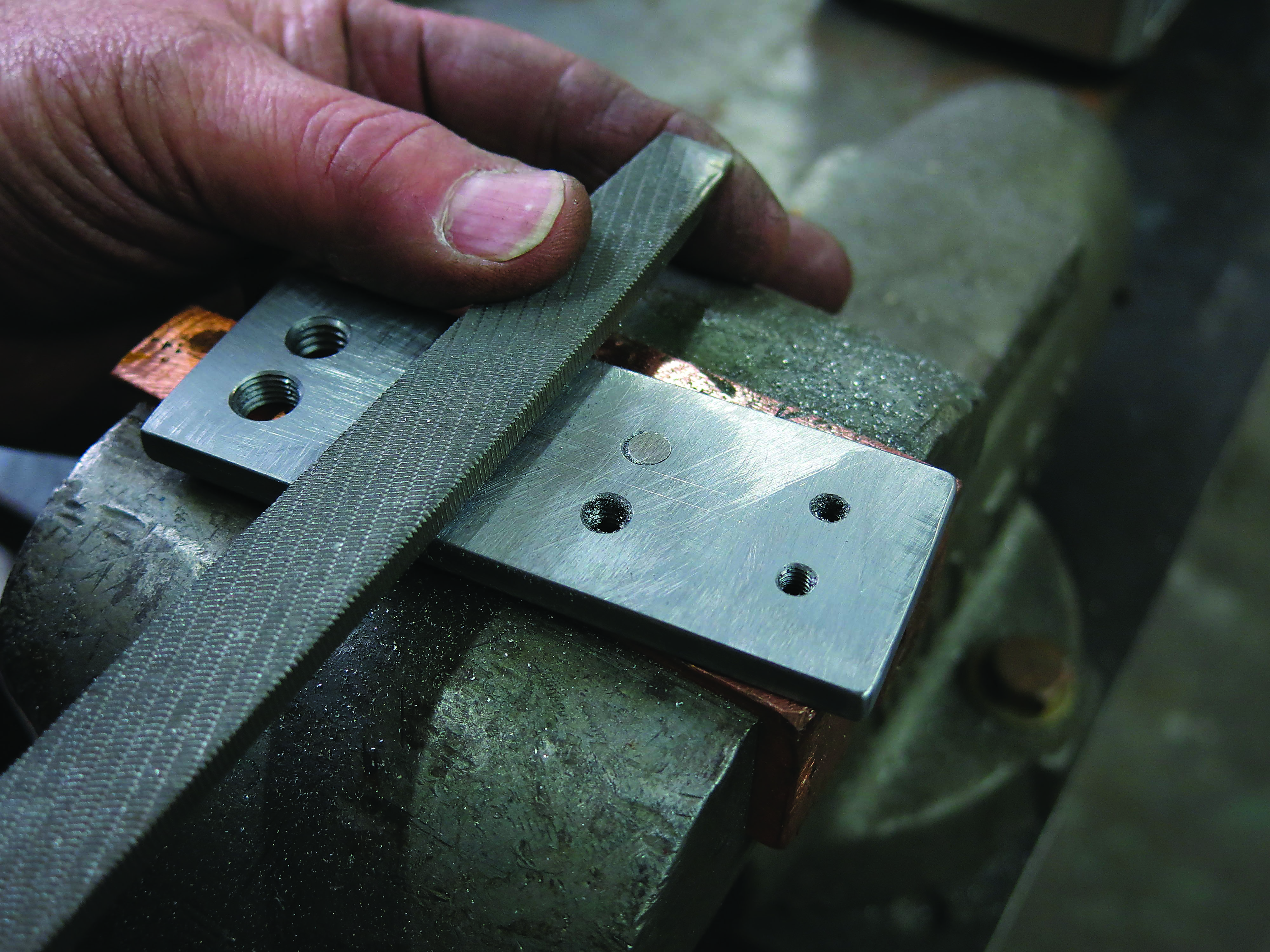

Over the years, technicians have come up with some quick and dirty methods for shortening fasteners. The oldest method is probably the venerable screw plate. Many old-timers’ toolboxes contain a flat plate that has an array of tapped through-holes. The idea is to thread the fastener through the appropriately tapped hole and set the desired length with a ruler or calipers. The offending projection is then ground or filed until it is flush with the plate (Figure 1).
With this method, the plate surface is the gage length of the desired fastener. After shortening, the modified screw is backed out of the tapped hole, an action that straightens the freshly shortened end and the all-important starting thread.
Screw plates works well. There are only two real drawbacks to them. First, too much time is needed to thread each fastener all the way through the plate to the desired length. Second, the screw is not clamped in any way to prevent it from rotating while hand filing. In addition, if you use a fast power tool such as an angle grinder to shorten a screw, the screw will frequently spin in the screw-plate tapped hole, changing the set length.

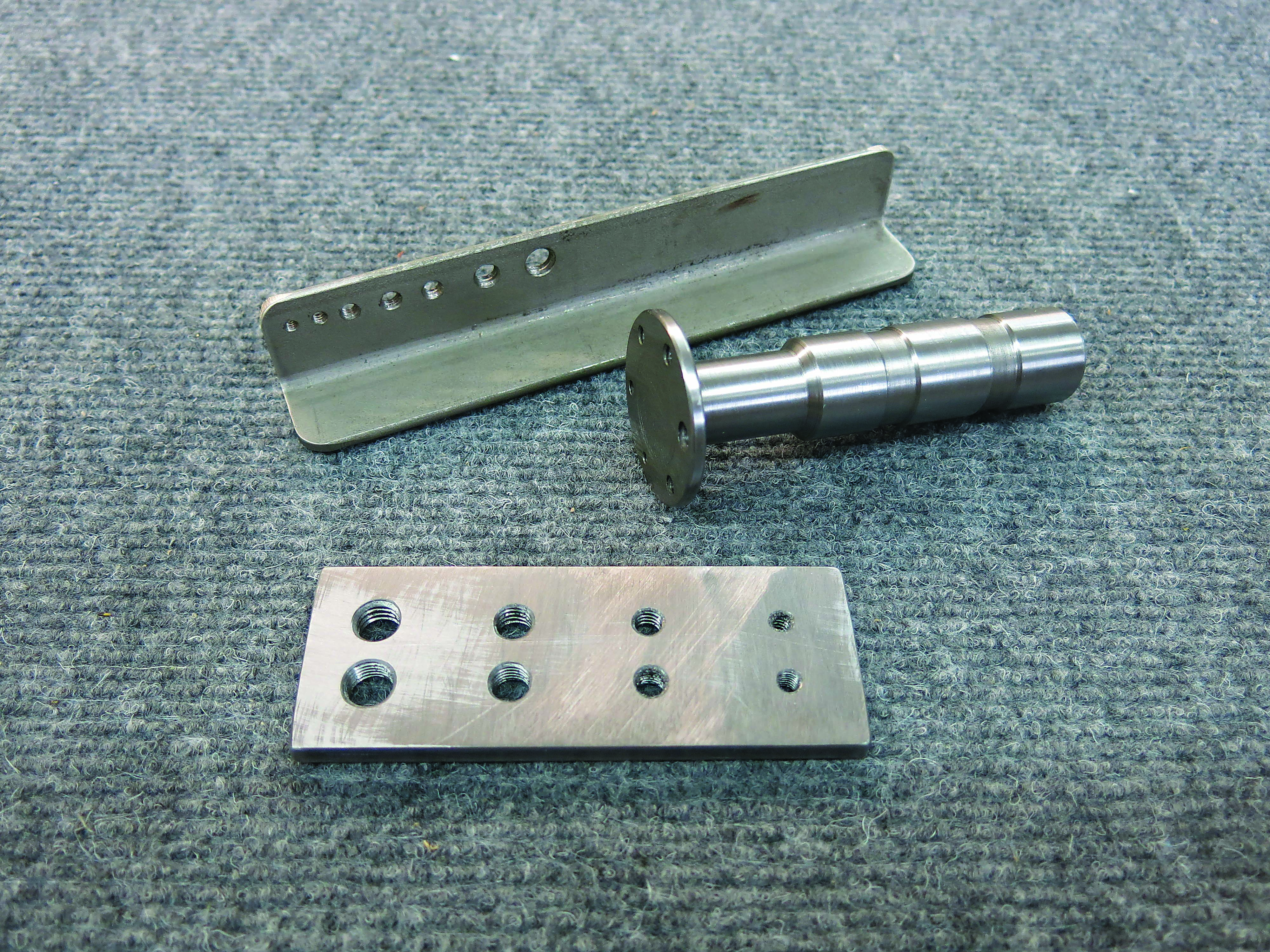

In an effort to find a solution to this much-despised task, I have made a few variations on the screw plate theme (Figure 2). One design provided a kind of handle to hold the fixture so the fastener could be brought to bear on a proper power tool, like a belt sander. This handle also keeps your fingers cool and safe. Unfortunately, this method, like the screw plate, sometimes allows the fastener to rotate when I least want it to.

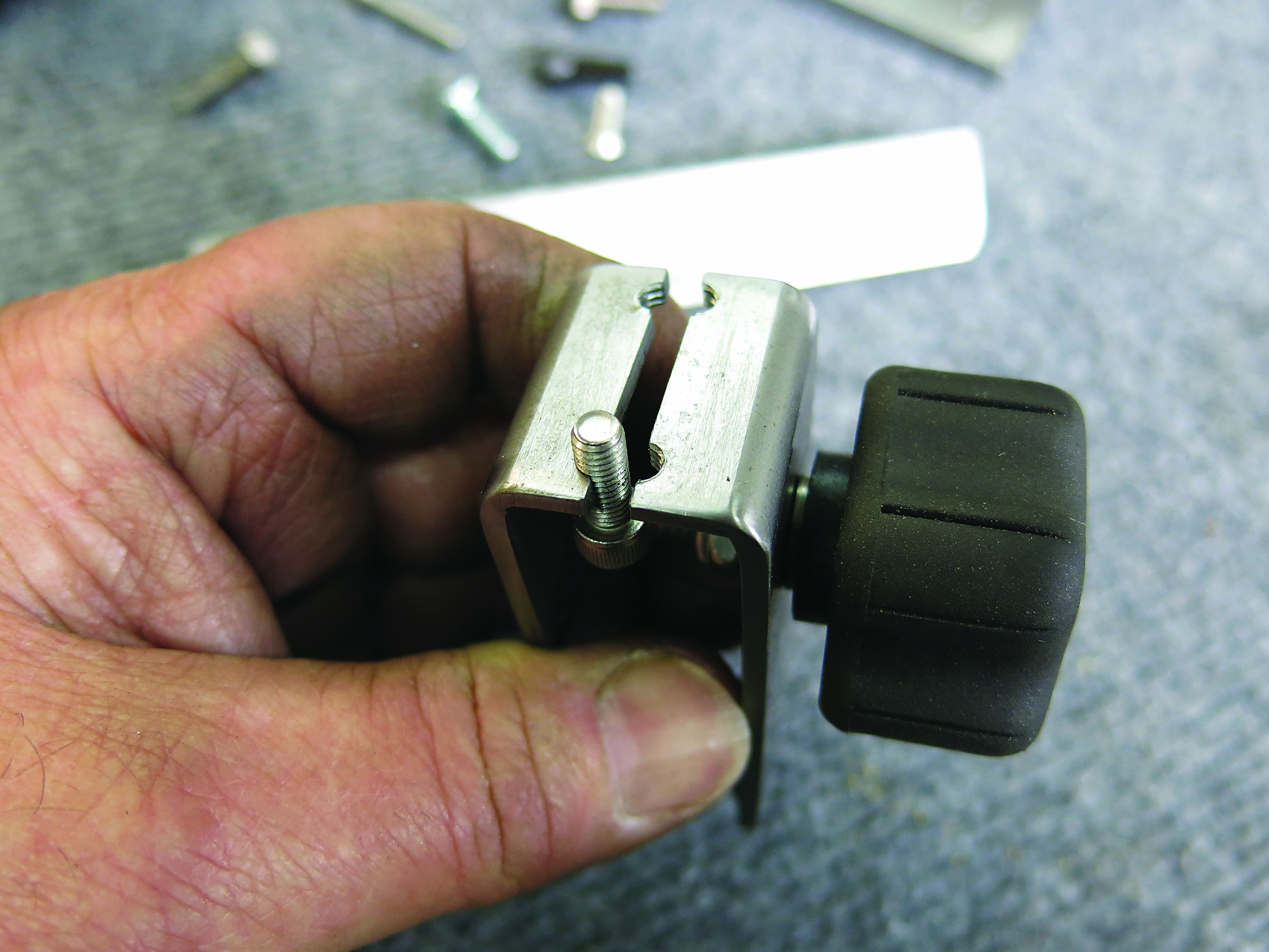

My best solution to date has been of the tubular variety. I drilled common rectangular steel tubing (1″×3″) and tapped one tube wall to accept the particular screw size (Figure 3). One wall of the tube is split exactly through the center of the tapped hole to form a vise-like jaw to secure the screw.
A clamping screw and knob arrangement then allows me to open the split tube wall more than the body diameter of the screw. This allows me to quickly insert the fastener into the threaded hole and set the desired length. Then, tightening the knob, the fastener is clamped firmly in the jaws, preventing it from rotating and changing length during the shortening procedure.
Tom Lipton's best solution was drilling common rectangular steel tubing and tapping it to accept the screw size. Photo credit: Tom Lipton
Figure 3. My best solution to date: I drill common rectangular steel tubing (1″×3″) and tap it to accept the screw size.
This whole contraption, which also provides a solid handle to hold onto, makes belt-sanding screws to length a cinch. After shortening, the screw can be backed out of the holder to help straighten that all-important starting thread.
It would be really annoying to have to stop in the middle of a job and make a new holder for another-sized fastener. To increase productivity, I invested the additional time up front and made a set of all the common screw sizes I encounter.
