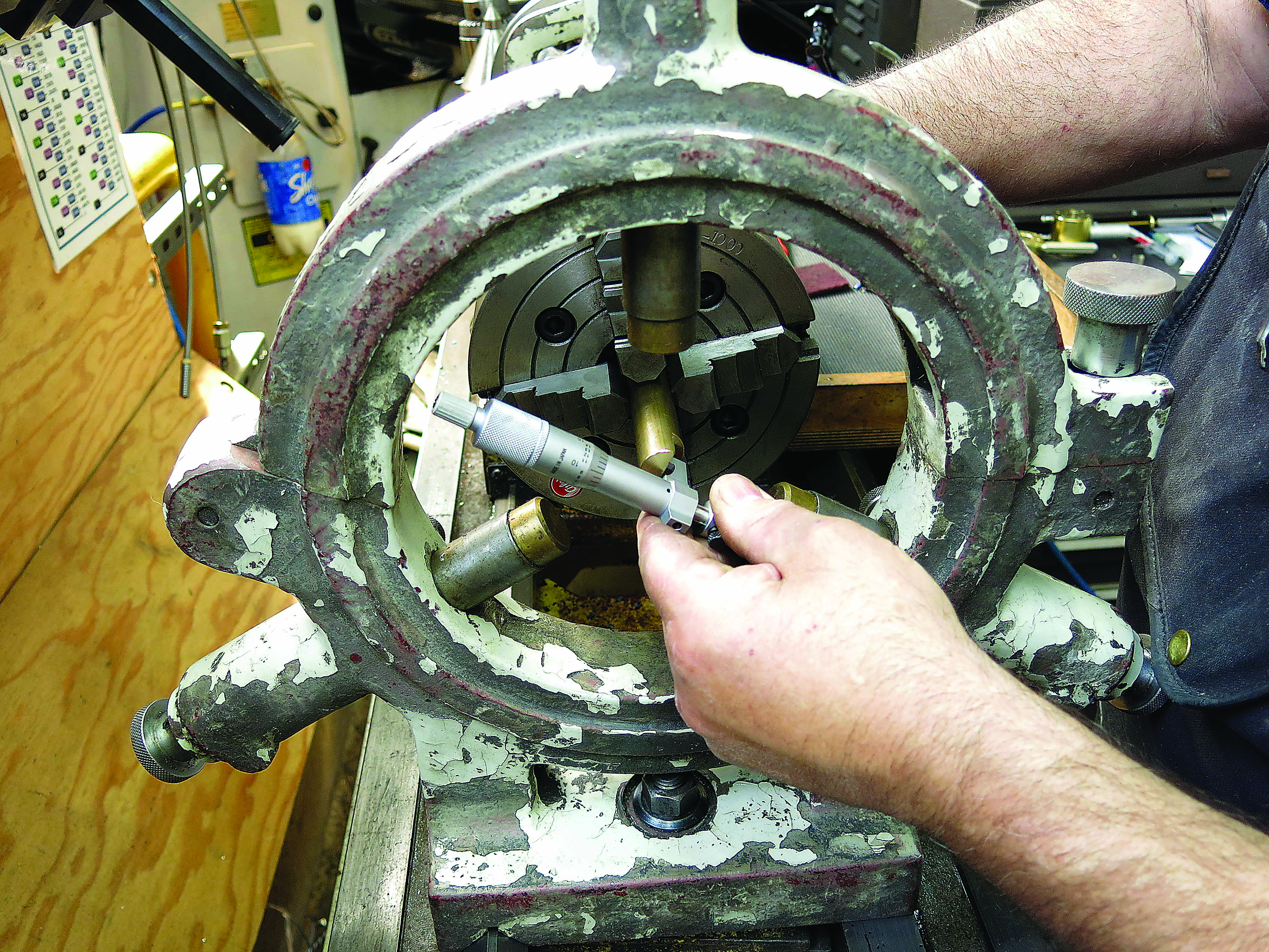

Figure 2. Use the tailstock-mounted 4-jaw chuck to assist with setting a lathe steady rest.
In addition, you can put a 4-jaw chuck to work in the tailstock of a lathe. Job shops are continually asked to perform repairs and odd one-off jobs. The 4-jaw chuck is the king of workholding for odd-shaped parts and mixed work. We can extend this broad workholding capability to include the tailstock of an engine lathe.
The tailstock-mounted 4-jaw is a great piece of tooling for holding tubular shapes—either round or square—where the outside surface of the tube is the reference datum surface (Figure 1). Bull or pipe tailstock centers can reference only the inside of the tube. They do not allow for accurate alignment. Both ends of the tube are indicated into accurate alignment. This allows minimal removal of material to clean the tube’s OD.
Construction of the tailstock 4-jaw is simply the plain back chuck mounted to a rotating bearing housing. The nonrotating part of the bearing housing has a Morse taper feature that plugs into the tailstock.
You can also use the tailstock-mounted 4-jaw chuck to assist with setting a lathe steady rest (Figure 2). The steady rest should be accurately aligned with the rotation of the lathe. If it’s not, long shafts or tubes can actually thread themselves out of the chuck jaws. Presetting the steady rest contacts puts you accurately on the axis of rotation and simplifies this sometimes tricky task.
