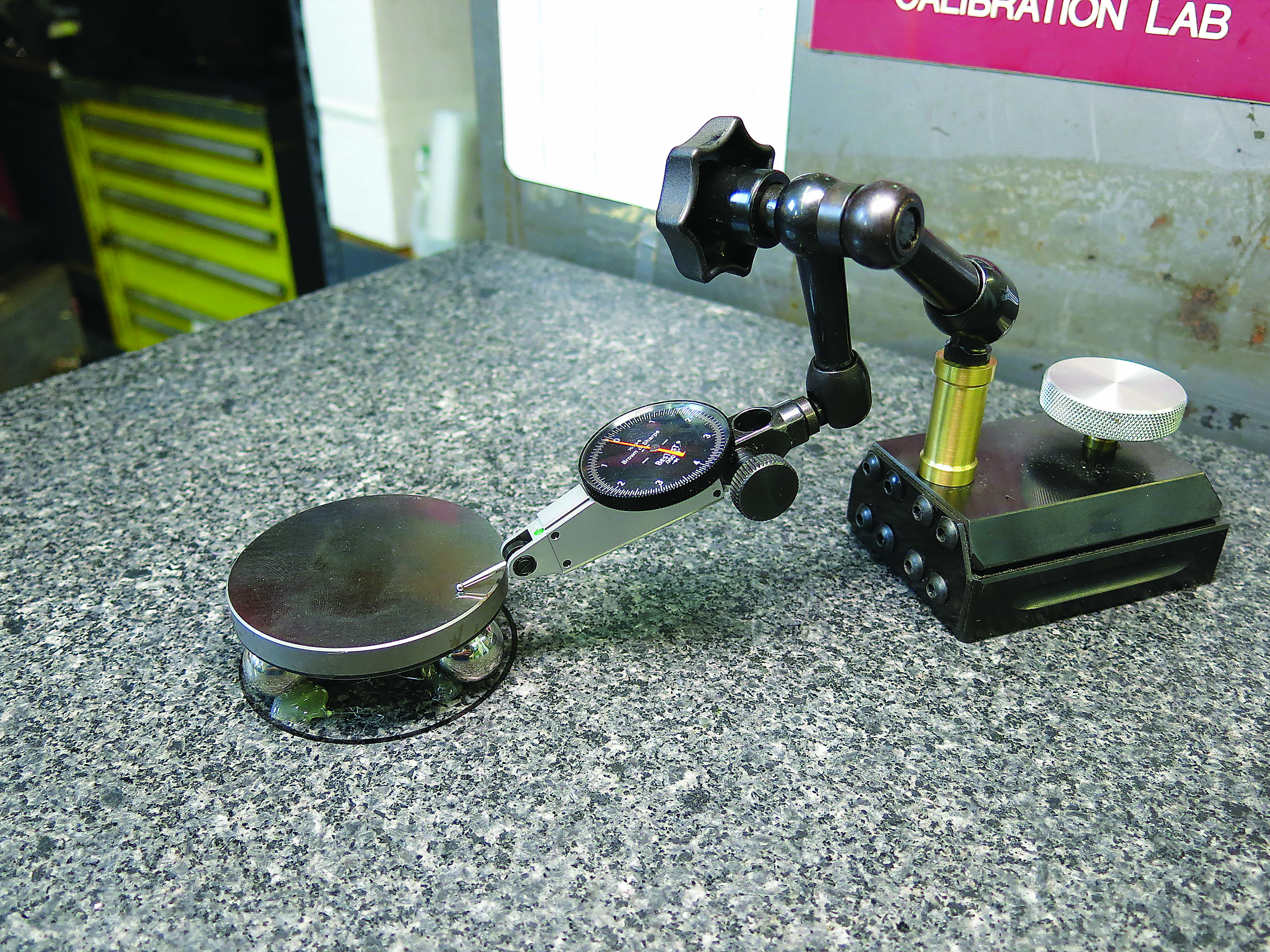

Balls can help when measuring for flatness by firmly supporting a surface plate. Figure 1 shows three balls that are hot-glued to a surface and act as precision kinematic rests that support the part when sweeping the top surface with an indicator to check for flatness.
Figure 1. Three balls are glued down to assist when sweeping the top surface of a plate to check for flatness. All images courtesy of T. Lipton.

The total indicator reading will tell the high-to-low deviation of the indicated surface. The three-point kinematic support assures the plate does not rock during interrogation. Denatured alcohol breaks the hot-glue bond without a fuss.

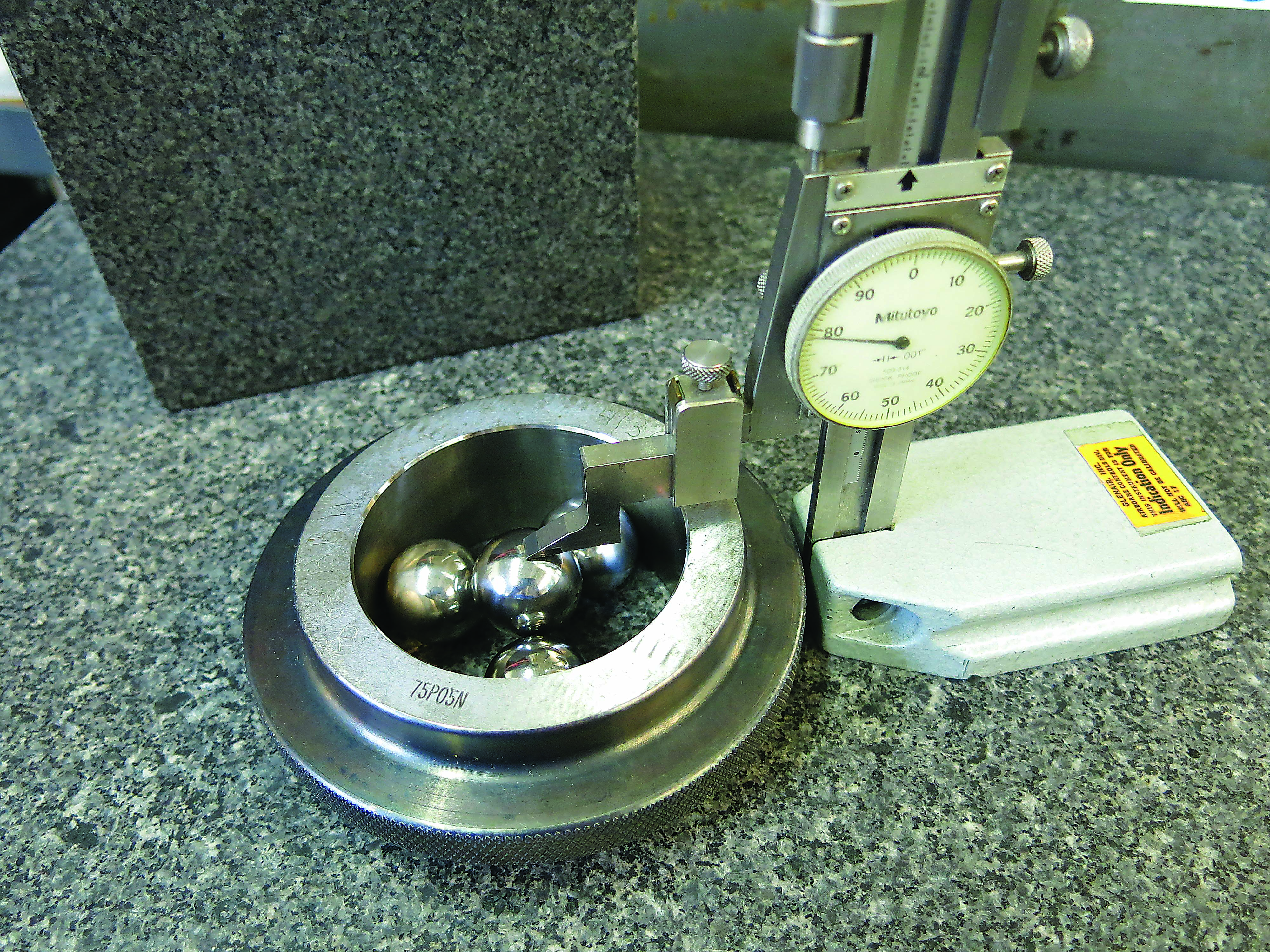

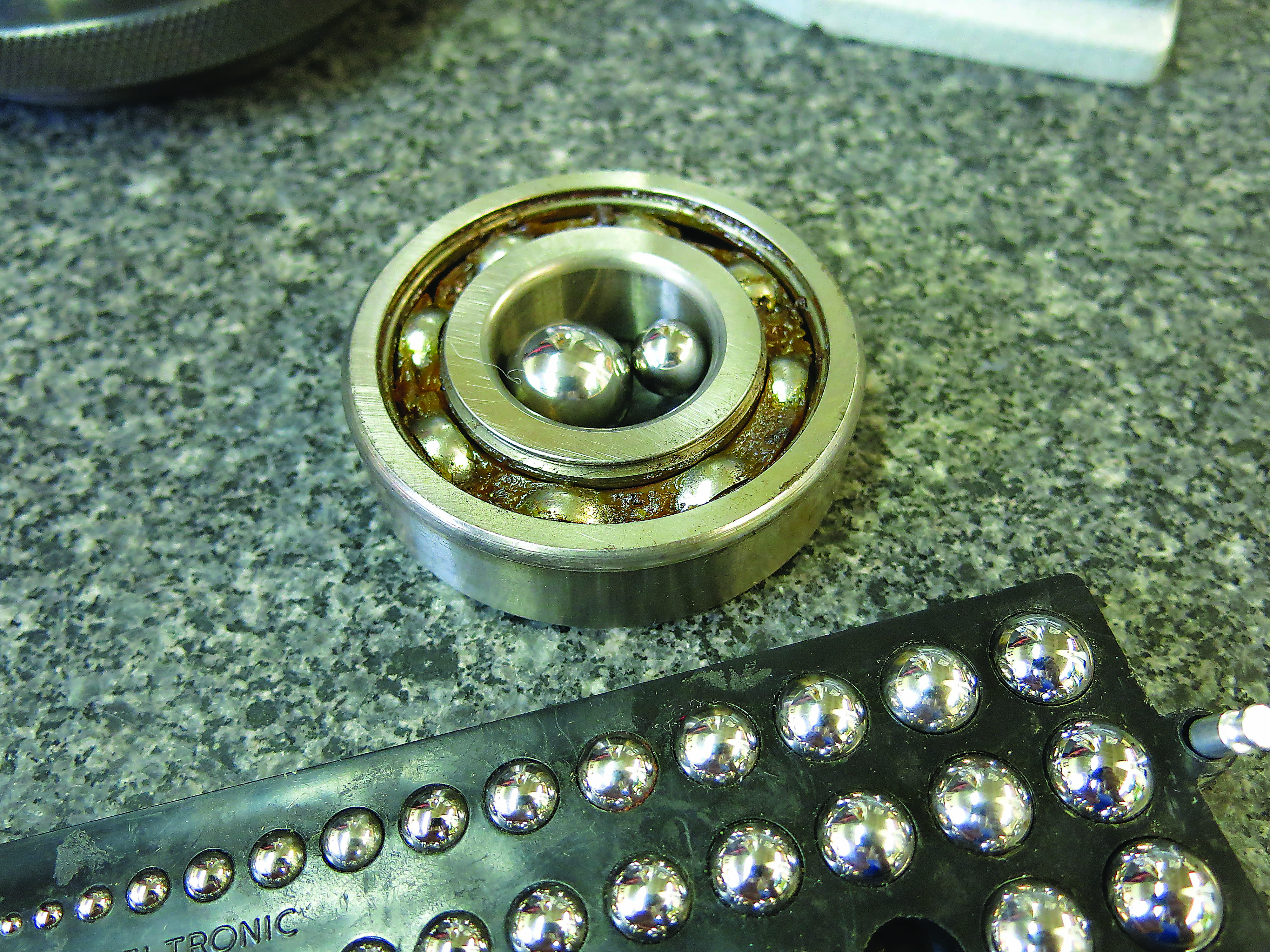

Precision balls also can act like a ring gage to measure IDs. In addition, only a height gage is needed.
Figure 2. The ID of a ball bearing being measured with two precision balls.
Figure 2 shows two precision balls being used to measure the ID of a ball bearing to an accuracy of 0.0001″. The graphical equation for determining the ID can be laid out in any CAD program with the appropriate tangent/tangent relationships, or by using this formula:
The “H” value is the measurement from the surface plate to the top of the highest ball, taken with a height gage. Choosing balls with small vertical distances between their centers makes this a very accurate way to measure ring IDs.
