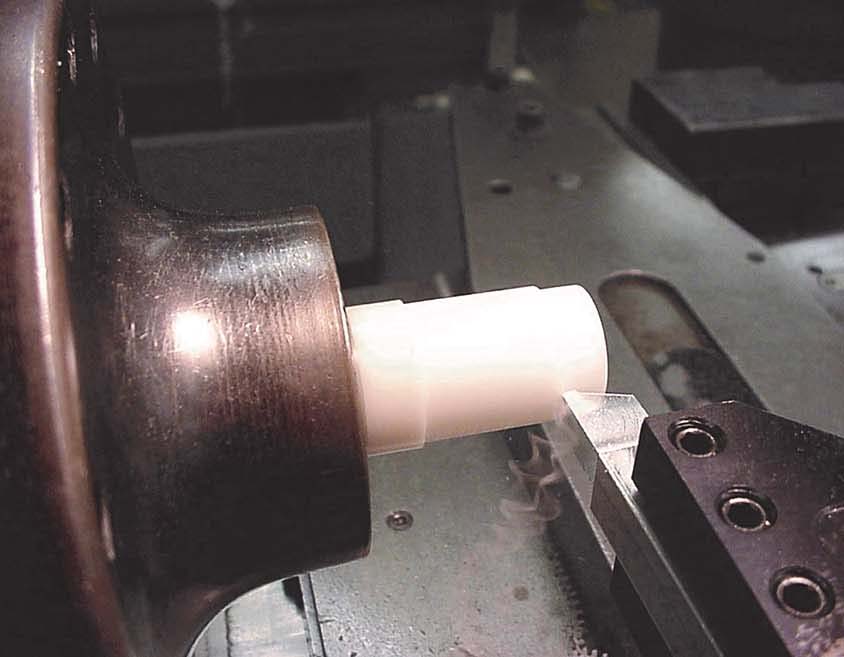

An aluminum tool machines a Delrin part. Image courtesy of J. Harvey​.
  • Cutting tools must be harder than the material they machine. This sound obvious within the realm of machining. To experiment, I took this concept a step further. I ground a piece of 7075-T6 aluminum into the shape of a lathe tool and proceeded to cut a Delrin part. Delrin is a rigid plastic, which is relatively stable and easy to machine. The aluminum tool held up well and imparted a fine surface finish.
