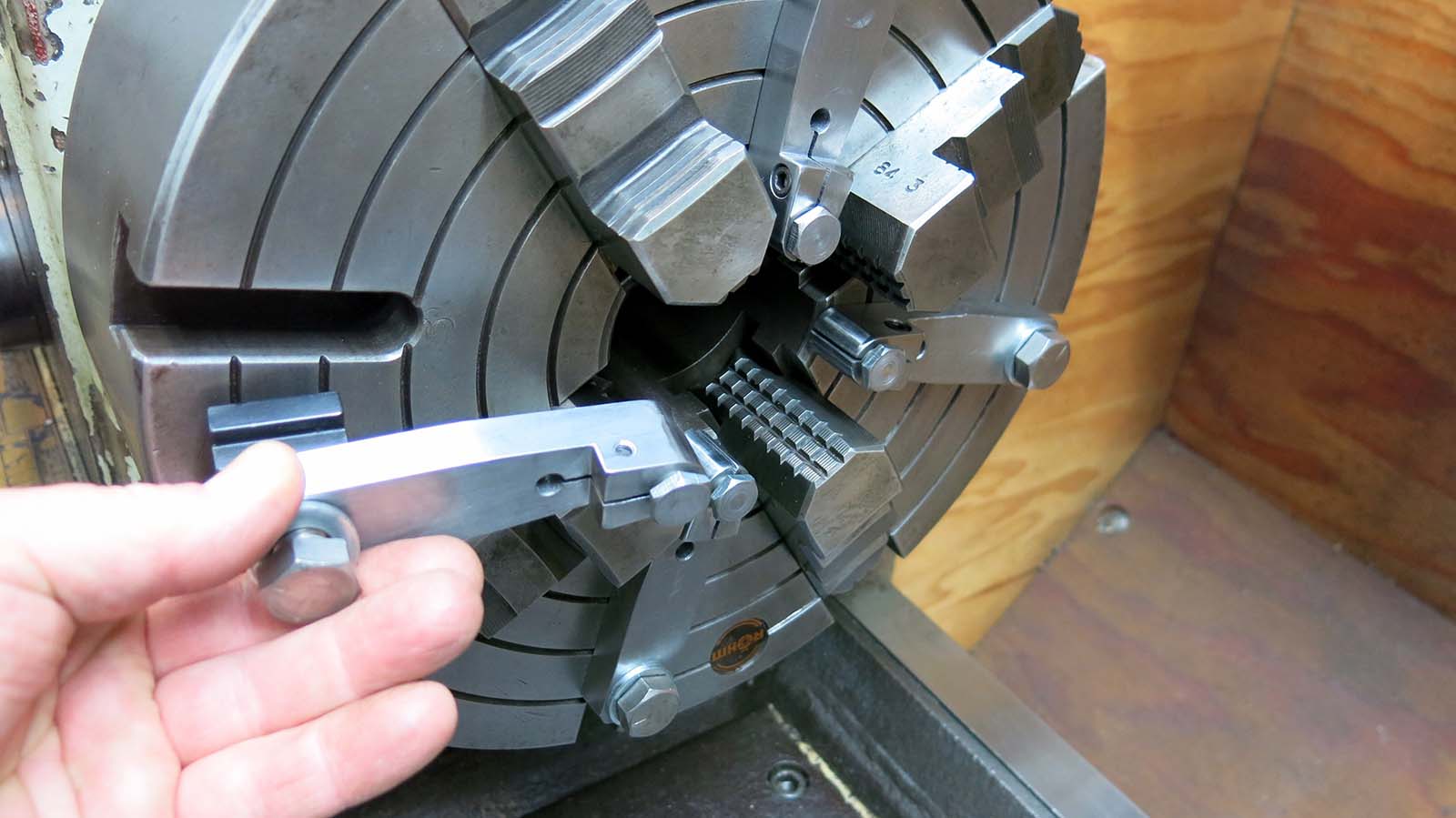

Figure 2 shows a set of adjustable backing supports for a 4-jaw chuck. I had been looking at the radial slots for a while, wondering how I might make use of them. During the winter holidays, I had some time between projects to make some workholding upgrades. These stops are the kind of setup-reduction tools that allow seamlessly moving from one job to the next without any heroic or sketchy workholding setups. Existing radial slots in the chuck are used to mount the adjustable stops.
Luckily, the 4-jaw chuck has some existing slots for radially adjusting the bars. These can easily be exchanged for a slot in the bar and a pair of tapped holes in the chuck face. Some chucks already have those tapped holes, which can be repurposed for this application.

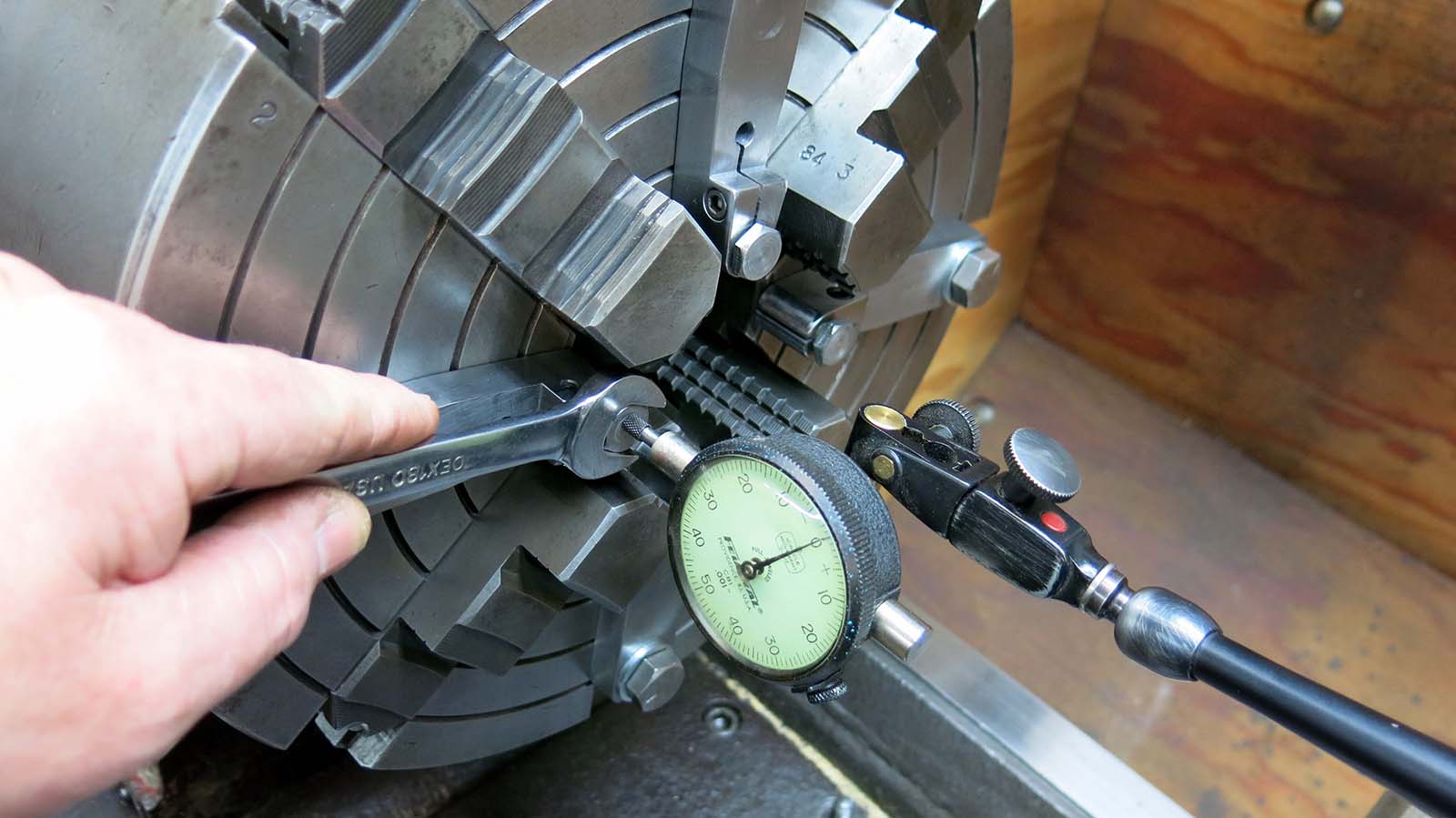

Adjusting the individual stops is a simple matter of adjusting the radial position to suit the workpiece being held, then indicating the faces of the stop bolts to the same Z-axis position. I face the contact surface of the fine thread fasteners to provide a nice, smooth backing surface that I can indicate. The side-locking screw clamps the backing bolt and prevents it from moving during use. In practice, I leave these clamp screws snug so the backing bolt doesn’t move but still allows me to make adjustments with a wrench while indicating.

These radial backing stops have important advantages when compared to the plate method. First, they have a through-hole, thereby making rings a cinch (Figure 3). The second advantage is, because you are adjusting each point, you can easily and precisely establish a plane perpendicular to the spindle axis. With the plate method, you are stuck with whatever the overall flatness of the plate happens to be.
Unlike pie or soft jaws, there are no spaces or recesses where chips can hide and throw the part off. Furthermore, the radial backing stops are much faster to set up. This system works equally well with manual and power chucks.
