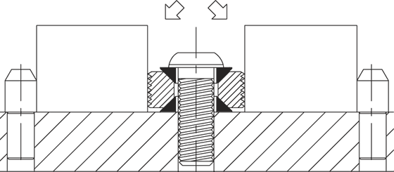

Better to go with a clamp designed for small workpieces. Many utilize a wedge activated through the turn of a screw, which opens a set of expandable rails, activates a cam or mechanically forces the vise jaw against the workpiece.
Carr-Lane Manufacturing Co.’s Tiny Vise is one such device. The St. Louis-based tooling provider offers the vise in serrated, V-jaw and double-edge configurations, the smallest of which is 0.250 " (6.35mm) high × 0.562 " (14.275mm) wide and uses a #8-32 screw to generate 60 ft.-lbs. of clamping force. Colin Frost, chief business development officer, said a pair of opposing wedges provides the vise’s clamping motion by drawing together as the clamping screw is engaged.
“The Tiny Vise not only applies force horizontally against the part but also presses it down,” Frost explained. “Multidirectional clamping such as this is very effective for fixturing small parts, where it’s important to securely grip the sides of the workpiece while keeping the top clear for machining.”

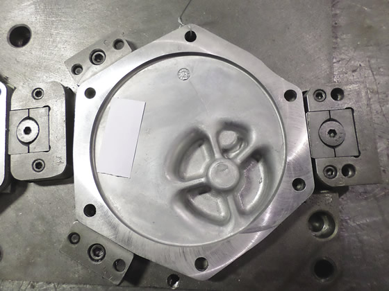

One of Carr Lane Manufacturing’s customers, Lund Manufacturing Co. Inc., Farley, Iowa, uses the Tiny Vise to clamp zinc and aluminum die castings. Tool and Die Manager Dennis Foxen pointed out several applications for this type of workholding, including facemilling a pump cover roughly 4” (101.6mm) in diameter, where a 3⁄8 "-high (9.525mm) CL-50-T twin-acting vise is actuated by a 5⁄16-18 flat head screw. “I built a steel block around three sides of the Tiny Vise, so when the screw is tightened, it pushes simultaneously against the block and the workpiece, forcing it against a set of stops.”

Foxen said most of the parts Lund machines are gripped with serrated jaws, which do a good job biting into the soft material typical of die castings. This approach is effective when clamping on noncosmetic surfaces, where the marring that comes with this type of jaw is unimportant, and on material that will later be machined away.

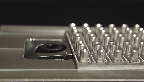

David Bishop, general manager of Mitee-Bite Products LLC, Center Ossipee, N.H., said many of the company’s clamps can be recessed into the fixture base (see photo on page 74). “We have customers gripping on less than 0.050 " with our Pitbull clamps and 0.030 " with the TalonGrips. However, it’s important when gripping this low on the workpiece that the proper clamping solution is selected, which is why we recommend that customers contact our engineering department for applications such as this.”
Sometimes, parts are secured via machinable wax, a castable thermoplastic material intended for temporary gripping of difficult-to-hold workpieces. In Mitee-Bite’s recessed clamp, the workpieces are “potted” in a fixture filled with a proprietary compound heated to 225° F (107° C). Once cooled, the carrier is cut from the potted workpieces, and the wax is remelted to release the finished parts.

Justin Gordon, general manager of Fixtureworks, said the vise uses a pair of wedges to simultaneously apply lateral and downward force. Like many of its competitors, the OK-VISE line offers a small footprint and surprising gripping capability: The Model BK2-VT measures just 29mm (1.14 ") across, yet generates clamping forces of 25 kN (5,620 psi).
