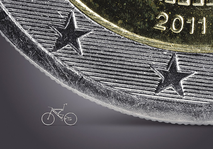

For machining applications, one of the main selling points of USPLs is that they shrink—and sometimes eliminate—the heat-affected zone. “The pulses are so short that heat doesn’t have time to be absorbed significantly, or at all, into either the material you’re cutting or adjacent structures,” explained Ramsey Cook, business development manager for the micro-processing group at Trumpf Inc., Farmington, Conn., a USPL manufacturer.
If a manufacturer cuts a thin line into steel with a USPL, Cook said, the laser vaporizes steel molecules, leaving little melt or debris along the cut.
Cut by a TruMicro picosecond laser from Trumpf, this “bicycle” is dwarfed by a 2€ coin. Image courtesy Trumpf.
