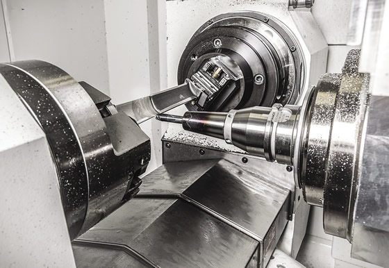

Starrag utilizes Haimer shrink-fit chucks due to their rotationally symmetric clamping bodies.

Starrag determined through R&D efforts to use shrink-fit chucks due to their rotationally symmetric clamping bodies. These chucks have fewer interfering contours and a high runout accuracy. As a result, Starrag engineers came across Haimer GmbH, Igenhausen, Germany, a shrink-fit toolholder manufacturer. (Haimer USA LLC is located in Villa Park, Ill.)
Haimer makes all its shrink-fit chucks, including standards, out of heat-resistant steel. For specific machining requirements, Haimer offers specials. The Power Shrink Chucks, for example, are suitable for special high-speed or high-precision milling applications.
Rutishauser explained that there are generally two procedures during blade production, starting with a roughing process where the chuck operates with a damping component to achieve a high cutting depth and feed. “During the finishing process, however, there aren’t any strong cutting forces,” he said. “At this point, a high runout accuracy and the balancing quality are important. The Haimer Power Shrink Chucks are suitable for both processes and, if the cutting gets even tougher, we simply switch to the heavy-duty chucks.”
When roughing and finishing titanium and other difficult-to-cut materials, cutting forces can be very aggressive on the interface between the machine spindle and the toolholder. “In the end, the key element is the part quality. It has to be perfect from the very beginning, because even the titanium blanks cost a small fortune,” Rutishauser said. “This is especially true regarding the surface quality, which constitutes an important factor. This is due to the fact that the turbine blades need a very precise structure in order to be very energy efficient. Nowadays, you can get the desired structure through milling and without any additional regrinding.” Starrag can achieve a surface quality of 0.4 µm Ra to 0.8 µm Ra, he noted.
