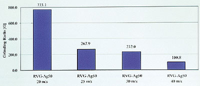

Grinding experiments performed on tungsten-carbide parts have revealed that, contrary to traditional thinking, slower wheel speeds improve process performance when straight oils are applied. The G-ratios for one series of tests conducted with RVG-Ag50 are charted in Figure 2. As can be seen, dramatically better wheel life was achieved at a speed of 20 m/sec. than at higher speeds.

Figure 2: Better wheel life was achieved with RVG-Ag50
at a speed of 20 m/sec. than at higher wheel speeds.

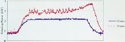

Another benefit of slowing down is a decreased power requirement. Figure 3 compares grinding power vs. time for two different wheel speeds. The plateau areas represent approximately 80 seconds of grinding time. Note the smooth power plateau at just over 2kW for the wheel speed of 20 m/sec. vs. the curve for 30 m/sec., which ranges from 3kW to about 3.8kW.
Silver Lining
Figure 3: Moderate wheel speeds also positively impact the required power.
The extra energy required at 30 m/sec. directly translates into detrimental heat at the wheel/workpiece interface. Also note the rise in the power requirement toward the end of the grinding cycle as workpiece growth and the actual depth of cut increase. The higher wheel speed of 30 m/sec. requires significantly more power and can result in unwanted levels of heat, causing workpiece expansion and/or cracking, as well as loss of tolerance control. This, in turn, can halt production.
