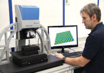

A QC technician using Alicona’s InfiniteFocus system at Rohde & Schwarz’s Teisnach plant.
InfiniteFocus combines the functions of a micro coordinate measurement machine with those of a surface measurement device, allowing users to measure form and roughness with the same system. The system achieves a vertical resolution down to 10nm, even across a large vertical scan range, according to Alicona.

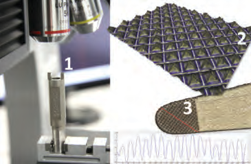

One of the manufacturing processes Rohde & Schwarz uses involves forming miniature switches (used for calibration standards in electronic measurement devices) from sheet metal. A defined relief, in a waffle pattern, is engraved onto the sheet metal surface with a stamping die to ensure the switches have reliable mechanical contacts.
“We manufacture the stamping dies used in the forming process by micromilling a pyramid-shaped structure with a total area of 70µm × 70µm and a height of 35µm into the tool surface,” Kokott said. “We cannot access or accurately measure the area with a tactile probe.”
The 3-D optical system provides an exact measurement of the stamping die’s form. “We verify the distance between the individual features by measuring peaks and valleys,” he said. “We also measure the angles of features and determine if they are properly partitioned.” In addition, InfiniteFocus is used as a QC device to randomly measure the machined sheet metal.
Ensuring the die will release properly is the key to the measurement process, Kokott said. “We’ve optimized this process and are now able to measure within microns in high resolution and with high repeatability. We can get the dies into production much faster than before.”
The InfiniteFocus system used by the Teisnach plant includes the optional Real3D rotation unit, which enables 360° form measurement. Using this and other system features, including automatic comparison between target geometry and CAD data and accurate measurement of geometries such as clearance and concentricity tolerance, Rohde & Schwarz can produce components faster and with greater accuracy.
Among other applications, Rohde & Schwarz measures its stamping tools with the InfiniteFocus system (1) to determine tool geometry (2) for release characteristics. After the tool is used, the stamped workpiece (3), with an embossed relief structure, is also verified.

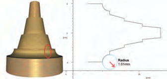

Many parts have steep flanks that include incisions, or indentations. InfiniteFocus can measure these indentations, according to Kokott. He added that the system can measure the surface quality of parts made from several different materials or coatings.
Kokott said: “We electroplate many of our components with gold or silver, which create different reflections. We also treat part surfaces using mechanical, chemical or galvanic means. Even with these difficult-to-measure surfaces, we can achieve precise results with the InfiniteFocus system. We can even measure painted components to verify whether they have a coarse-, medium- or fine-grain structure.”
Rohde & Schwarz produces parts with complex forms and steep flanks, such as this one, at its manufacturing plant in Teisnach, Germany.
