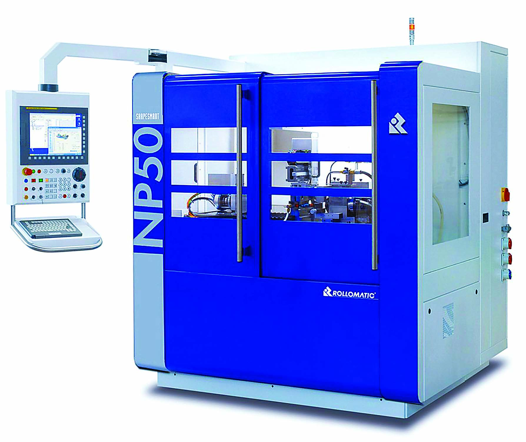

Developed by Le Landeron, Switzerland-based machine tool manufacturer Rollomatic SA, the ShapeSmart model NP50 is a five-axis “pinch/peel” grinding machine. The NP50 can grind carbide, high-speed steel and stainless steel to produce cylindrical components with excellent surface finish and concentricity, according to the company.

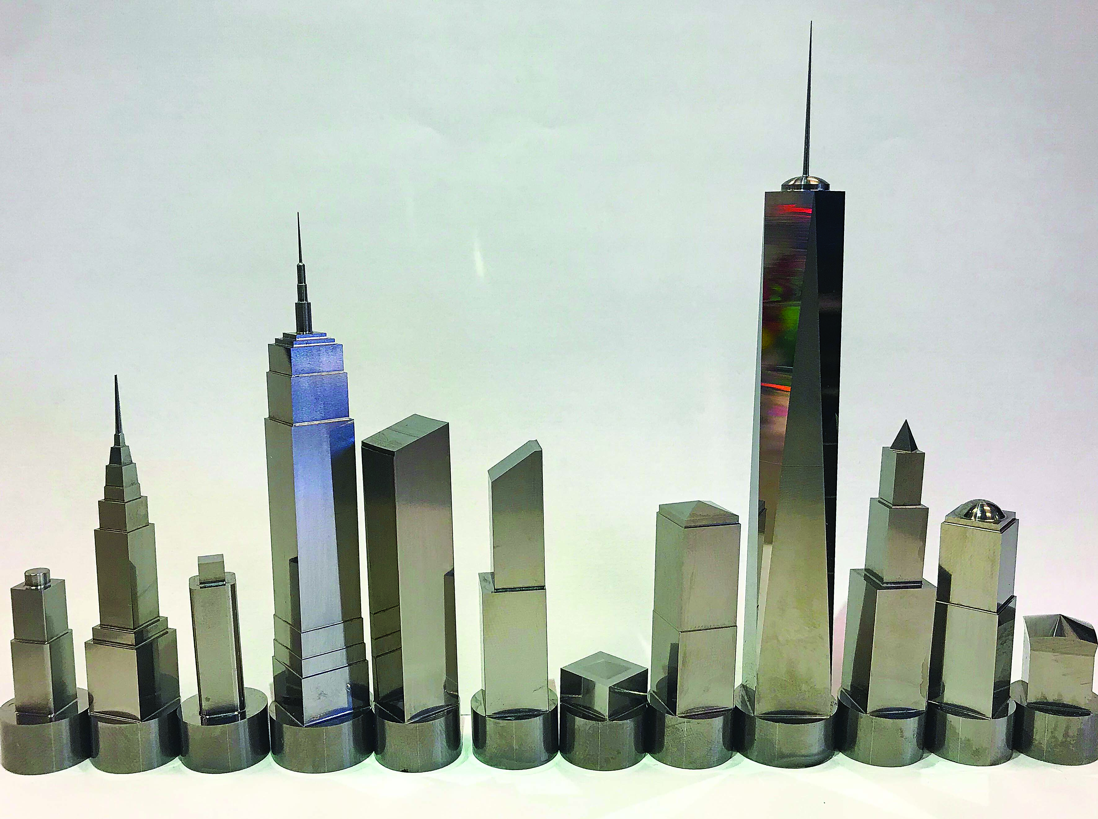

The pinch/peel process was used to grind these nonround carbide punches resembling buildings along New York City’s skyline. Image courtesy of Rollomatic

Common nonround shapes that can be made by the NP50’s pinch/peel process include ovals, squares and rectangles. He said the process also can produce “weird” shapes. For example, one of Rollomatic’s magazine ads shows a group of carbide parts that look like the buildings along the New York City skyline. These parts all were made in one chucking by the NP50, he said.

Rollomatic also touts new technology in the NP50 aimed at making the nonround grinding process faster and more accurate. For example, the belt-driven workhead in older Rollomatic grinders has been replaced by a workhead with a direct-drive spindle.
The ShapeSmart model NP50 pinch/peel grinding machine can grind both round and nonround parts. Image courtesy of Rollomatic
“Though we had a very precise system before,” Schwarzenbach said, “with direct drive and an encoder on the workhead, we can interpolate very accurately for nonround grinding.”
Thanks to the increased accuracy made possible by direct-drive technology, he said nonround parts made by the NP50 lack the transition lines visible on components made with the belt-driven system. Since there’s no need to slow down the process to deal with appearance-marring lines, the NP50 can complete nonround grinding 20% to 30% faster than belt-driven counterparts, he said.
In addition, both round and nonround parts produced by the process benefit from a switch from asynchronous to synchronous motors. Schwarzenbach said synchronous motors provide constant spindle rpm that increases grinding accuracy and produce a much more efficient torque curve than regular asynchronous motors.
