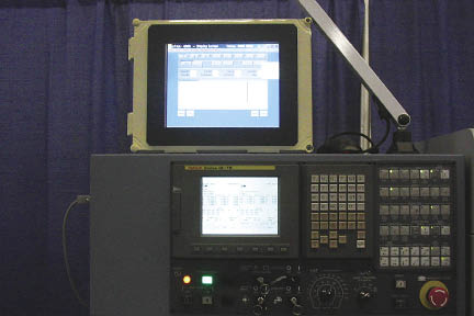

Sensor-based monitors, such as the one from ATAM, track machining operations and compare each procedure to an input signature of a programmed cycle run. Any deviation from the signature cycle can activate an alarm or prompt a shutdown, thereby averting a crash. The advantages are many: controlling quality, reducing waste, protecting against tool and parts damage and allowing lights-out manufacturing.
Often used for high-volume and expensive part runs, the benefits of process monitoring also extend to the smaller runs typically tackled by job shops.
The ATAM displays machining operations and tool condition on a monitor in the form of a graph-like scrolling signature.

The ATAM incorporates a computer-based control and sensors. The unit connects to the machine’s controller and its sensors are placed on the machine. Using vibration as its primary criterion, the ATAM’s report on tool condition is displayed on a monitor in the form of a graph-like scrolling signature. (ATAM Systems offers two types of process monitors: the ATAM 6000, which includes an interactive touch-screen; and the ATAM 6000-PC, which includes all of the 6000 features, but shops substitute their own PC in place of the interactive touch screen.)
The system alerts operators when preset machining parameters are exceeded. Slightly elevated vibration levels due to a tool beginning to wear, for example, might prompt a warning, in which case the machine would stop at the end of a cycle. Vibration levels beyond a chosen crash limit would shut down the machine.
