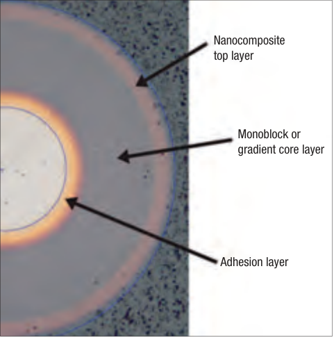

Platit’s current generation of nanocomposite coatings feature an adhesion layer, a monoblock or gradient core layer and a nanocomposite top layer. Total thickness of the coating system is 2.72µm.
“We are currently focused on machining steels hardened up to 54 HRC,” Reed said. “The coating is also very good in machining of prehardened steels and powder metallurgy materials.” Reed said Duralor’s current work is mainly in uninterrupted turning applications, although the company expects to ramp up development of CBN-coated inserts and round tools for interrupted cutting in the coming months.

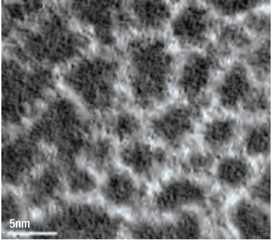

The coatings feature nanocrystalline TiAlN, AlCrN or AlTiCrN grains embedded in an amorphous silicon-nitride matrix. Platit says this arrangement prevents grain growth during deposition and maintains hardness greater than 50 GPa.
Courtesy of Swiss Tek
Transmission electron micrograph shows the structure of nanocomposite coating, consisting of dark AlTiN nanocrystals 3nm to 4nm in size surrounded by approximately 1nm of lighter-colored amorphous Si3N4.

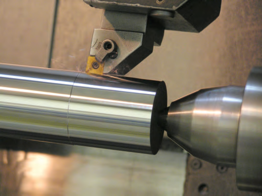

One contract coater using Platit equipment to deposit the coatings is Swiss Tek Coating Inc., New Berlin, Wis. Swiss Tek President Peter Bartos said the company deposits two nanocomposite coatings using its Nano-Tek and Nano-Tek/Cr processes. The former process deposits an AlTiN/Si3N4 material; the latter deposits AlCrN in a Si3N4 matrix. “In either case, the amorphous Si3N4 fills the voids between the AlTiN or AlCrN nanocrystals,” Bartos explained.
According to Bartos, nanocomposite coatings are used on solid round tools and inserts for threading, milling and turning, and they are accounting for an increasing share of his company’s business. “The main benefits are very high hardness and heat resistance,” he said. “With conventional AlTiN, we had pretty much hit the limits in terms of those properties, but these nanocomposite materials broke through those barriers.”
Bartos said oxidation temperatures—the point at which the coatings would combine with oxygen in the atmosphere and begin to break down—for the nanocomposite materials are in the range of 2,000° to 2,200° F. “That’s significantly higher than the best conventional PVD coatings, and very close to the original sintering temperature of the carbide substrate,” he said.
Such high heat resistance makes nanocomposite coatings useful in multiple high-performance or high-speed machining applications, he added. “What we have found is the chromium-based coating has a broader application range than the titanium-based material, which seems to be better for hard milling of steels.”
