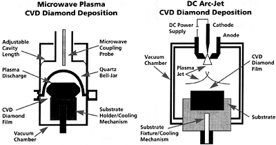

Unlike HTHP diamond and metal-sintered PCD, the manufacture of CVD diamond does not require the high pressures needed to mimic the forces of nature deep within the Earth. Instead, CVD diamond is synthesized using high-temperature, low-pressure gases contained within special vacuum chambers (Figure 1). In these “reactors,” hydrogen- and hydrocarbon-gas mixtures are energized to an “activated” glowing state that does not normally exist in nature. This activated chemistry allows pure, CVD polycrystalline diamond to be deposited at temperatures ranging from 800° to 1,100° C.
Sparkling Performance
Figure 1. CVD diamond can be produced using several different methods, including microwave-assisted, arc-jet and hot-filament (not shown) deposition.
