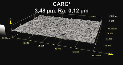

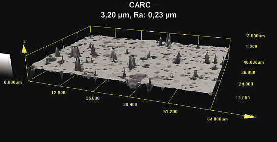

Also outperforming by a factor of two is the new technology’s ability to deposit smoother coatings compared to the company’s previous technology, according to Eerden. For instance, CARC+ can achieve a surface finish of 6.3 µin. (0.16µm) Ra for an 80µin. AlTiN coating. Coatings without a high aluminum content, such as TiN and TiAlN, will be even smoother, because aluminum has a low melting temperature and, therefore, creates more smoothness-impeding metal droplets.

Courtesy of IHI Hauzer Techno Coating
These images were made with a confocal microscope and show the density and height of metal droplets (peaks above the coating) for coatings deposited with two technologies: Hauzer’s CARC+ (3.48µm, or 137.01µin., thick) and CARC, an earlier method (3.20µm, or 125.98µin., thick).
