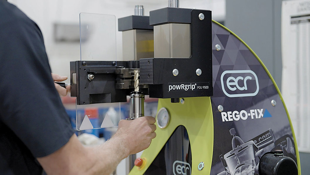

image of Hand
The vibration-damping taper-to-taper, press-fit, collet-holding design of the powRgrip system creates a juncture point, or gap, that essentially interrupts the waves of vibration to reduce their strength and severity. Rego-Fix USA

The toolholders are balanced by design to minimize tool runout. And in terms of speed, holder assemblies are balanceable for use at speeds up to 42,000 rpm. Additionally, the vibration-damping taper-to-taper, press-fit, collet-holding design of the powRgrip system creates a juncture point, or gap, that essentially interrupts the waves of vibration — caused by runout — to reduce their strength and severity.
With the new holders, Ed Carpenter Racing reports that it maintains precision and critical surface finishes, extends tool life, minimizes tool runout to less than 0.0051 mm (0.0002″) and shortens cycle times.
