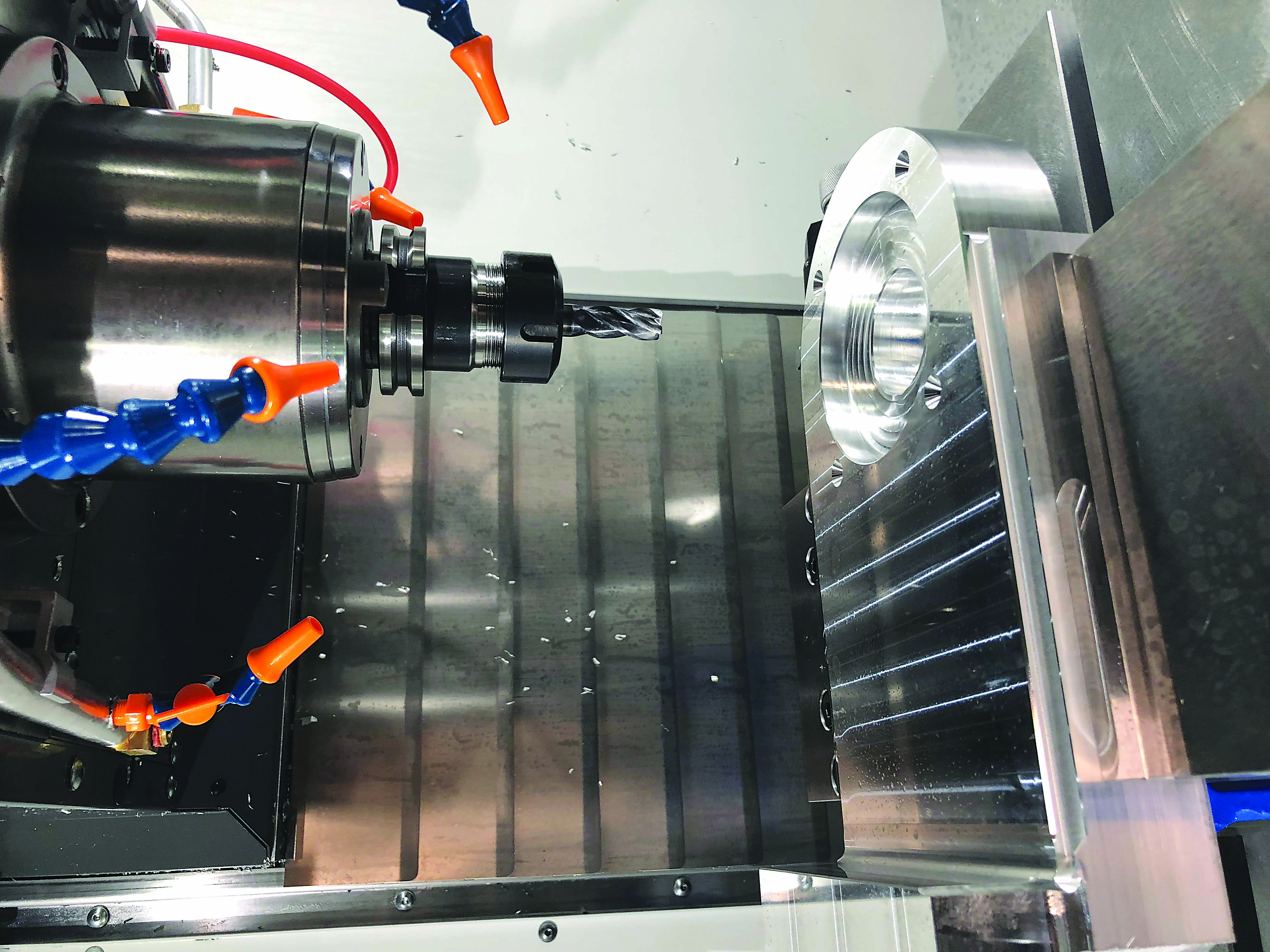

Automated Design produces a part at its machine shop
with a Basic Mill cutting tool from Haimer. Image courtesy of Automated Design

Looking to streamline the process and improve part quality, ADC moved into a facility last spring that enabled it to set up a machine shop. After installing a new Haas VF-2 vertical machining center the first week of January, ADC hired a machinist and began the process of tooling up the VMC, Bitsky said.
Bitsky said Drew Strauchen, vice president of Haimer USA LLC, Villa Park, Ill., is a longtime friend who was glad to provide consultation. “We were able to have some good, honest conversations with Drew about what we really needed and what he recommended.”

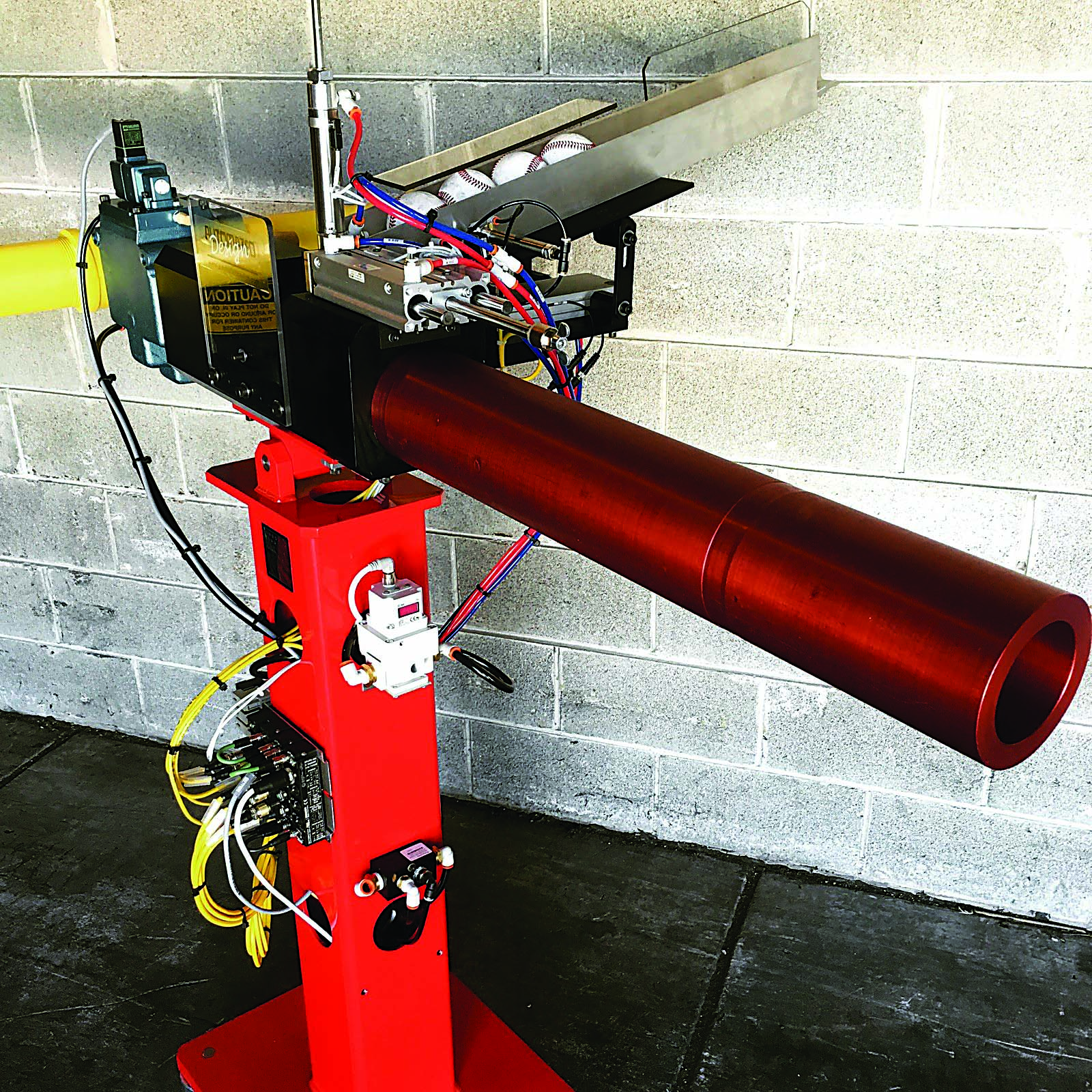

ADC Cannons, which can be mounted to a pedestal, are the basis
for numerous sports development systems. Image courtesy of Haimer USA
He added that after hearing what Strauchen had to say, ADC purchased about two dozen ER collets with 5µm precision collets and Basic Mill cutting tools from Haimer. “They are definitely more expensive than some of the other options, but we wanted to have the best tools to make the best parts with,” Bitsky said. “That is our goal.”
In addition to the solid-carbide cutters from Haimer, ADC applies HSS tools from other toolmakers. “We are trying to pick strong vendors in every aspect of what we do,” Bitsky said. “We are a small business that leans on our vendors to assure we are getting the right products.”
