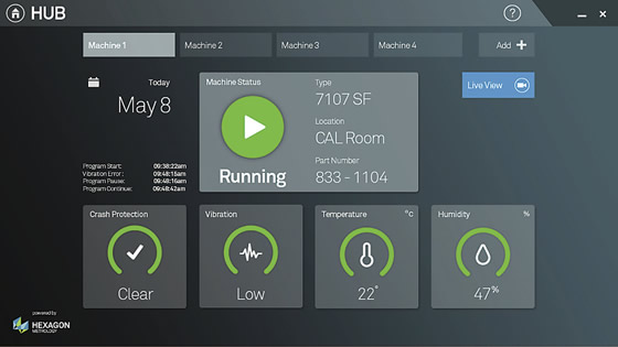

Hexagon Metrology’s MMS Pulse system offers a central dashboard to display variations in temperature, vibration and humidity, which operators can access at any time. Image courtesy Hexagon Metrology.

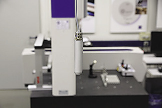

In addition to basic air-temperature sensors, new systems, such as TEMPAR from Carl Zeiss Industrial Metrology, Maple Grove, Minn., offer an array of sensors to be deployed around a metrology lab, giving a comprehensive picture of its atmosphere.
“Think of a security system for your home,” said Zeiss product manager David Wick. “A security system monitors all of your windows and doors and lets you know if anything goes wrong. TEMPAR tracks and records temperature and humidity and how they change over time, and lets you know if something goes out of spec. It can display the information on a computer screen, it can send you an email or text message, or you can check the readings via remote web access. It’s like a security system for your measuring room.”
Within the typical range of 15° to 30° C, precision CMMs are spec’d so the room temperature can vary 1° C per meter, Wick said. “Essentially, that means the temperature at the very edge of the room has to be within 1° C of the temperature when you take one step into the room. We use these tight tolerances because performance-measurement equipment is extremely precise, and it is absolutely essential to ensure your measuring room stays in spec throughout the measurement process.”
The entry-level TEMPAR system includes eight sensors and a touchscreen-equipped computing node, which operators can use to view and interact with the readings. More expensive packages offer more sensors and additional functionality, such as a mobile workstation that can be moved around the room or connectivity using Zeiss’s PiWEB software protocol.
