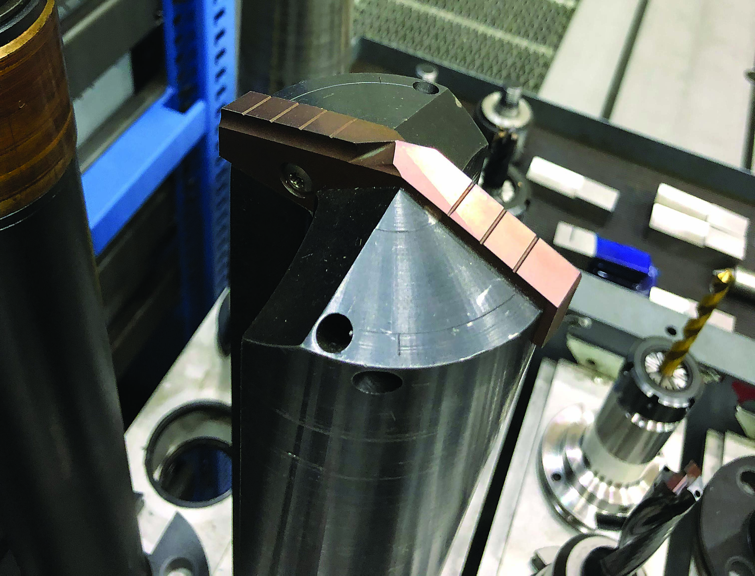

Allied offers Super Cobalt 90° indexable spade drills in a variety of diameters for spotting and chamfering. Image courtesy Allied Manufacturing & Engineering.

Spot drills have evolved and are no longer “just spotting tools,” according to Valenti. For instance, Ingersoll’s Spot-In FAK indexable spotting tools are offered in 82°, 90°, 118°, 135° and 140° styles for a variety of operations: spot drilling, countersinking, engraving, chamfering and edge deburring.
A center drill (top), which is usually double-ended, is sometimes used for spot drilling but is not as accurate as a true spot drill (bottom). Image courtesy Guhring.
Iscar also offers tools with interchangeable carbide bits, such as the SumoCham drill or the Multimaster, which is intended more for milling but can perform chamfering and spot drilling. “However, we recommend you create more of a prehole than a starter hole,” Davis said. “Basically, you prehole with a short drill about 1 diameter deep. A prehole is within an H8 tolerance of the secondary drill with a drill point the same size or larger than the secondary drill. The prehole supports the drill margin as well as the point.
“We recommend taking the drilling tool and putting chamfering bits on it,” Davis added. “The drill will be a step drill with a drilling insert on the end and chamfer inserts toward the back of the drill, allowing for drilling and chamfering/counterboring with one tool.”
