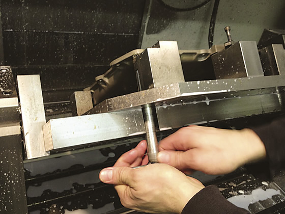

Grippers are placed where needed to support the workpiece during machining, while enhancing machine tool access. All images courtesy Blue Photon Technology and Workholding Systems.

To release the workpiece after machining, simply turn the gripper a quarter turn counterclockwise. The localized torque instantly shears the adhesive bond.

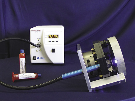

The UV light is activated for 30 to 60 seconds, depending on the joint thickness and required holding strength.
The system has been modified somewhat since De Meter’s original design. Blue Photon still uses the grippers and proprietary UV-curable adhesives, but these have been incorporated into a transfer tool methodology mounted on a zero-point fixturing system. Depending on the configuration, a starter kit costs $10,000 to $15,000, although Kelly said the individual gripping components and adhesives can be purchased separately.
“Once you have the UV light source and hardware, the ongoing costs are low,” Kelly said. “Depending on the workpiece and adhesive gap thickness, which can range from 0.02 ” to 0.125 “, you can figure on 100 to 200 applications for each 30cc tube of adhesive, or roughly $2 per gripping application. In higher-volume applications, the adhesive can be supplied in larger containers, which can lower the adhesive cost significantly.”
If you think glue is a wimpy way to grip a part, think again. According to Kelly, four ½ “-dia. grippers are strong enough to withstand aggressive milling forces. Clamping involves squirting a small amount of adhesive into the gripper body, loading the part, applying UV light for 30 to 60 seconds and moving the transfer tool to a machining center. When done, a quarter turn with a wrench debonds the gripper, after which any leftover adhesive can be removed with hot water. The system is suitable for most any material, including glass and ceramic, and withstands water-soluble cutting fluids and oil.
