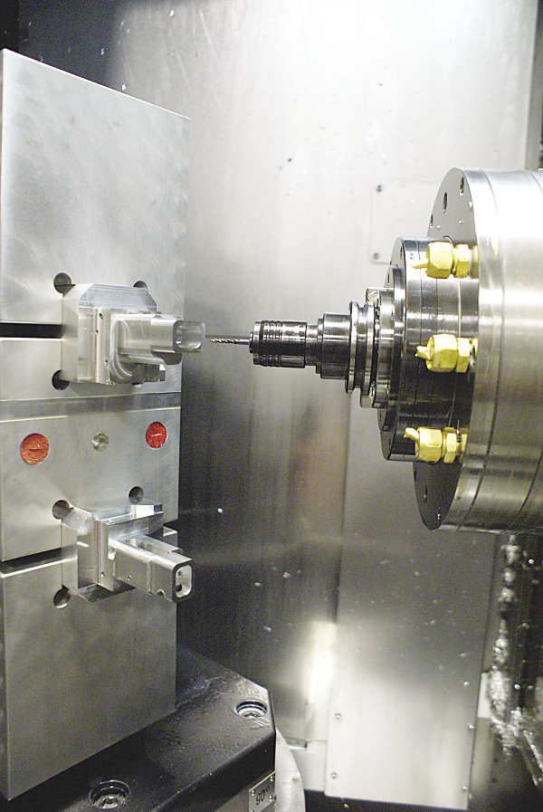

Reinhold Industries machines plastic-injection cylinder bodies held on a KIWA tombstone in a KIWA HMC. Image courtesy Reinhold Industries.

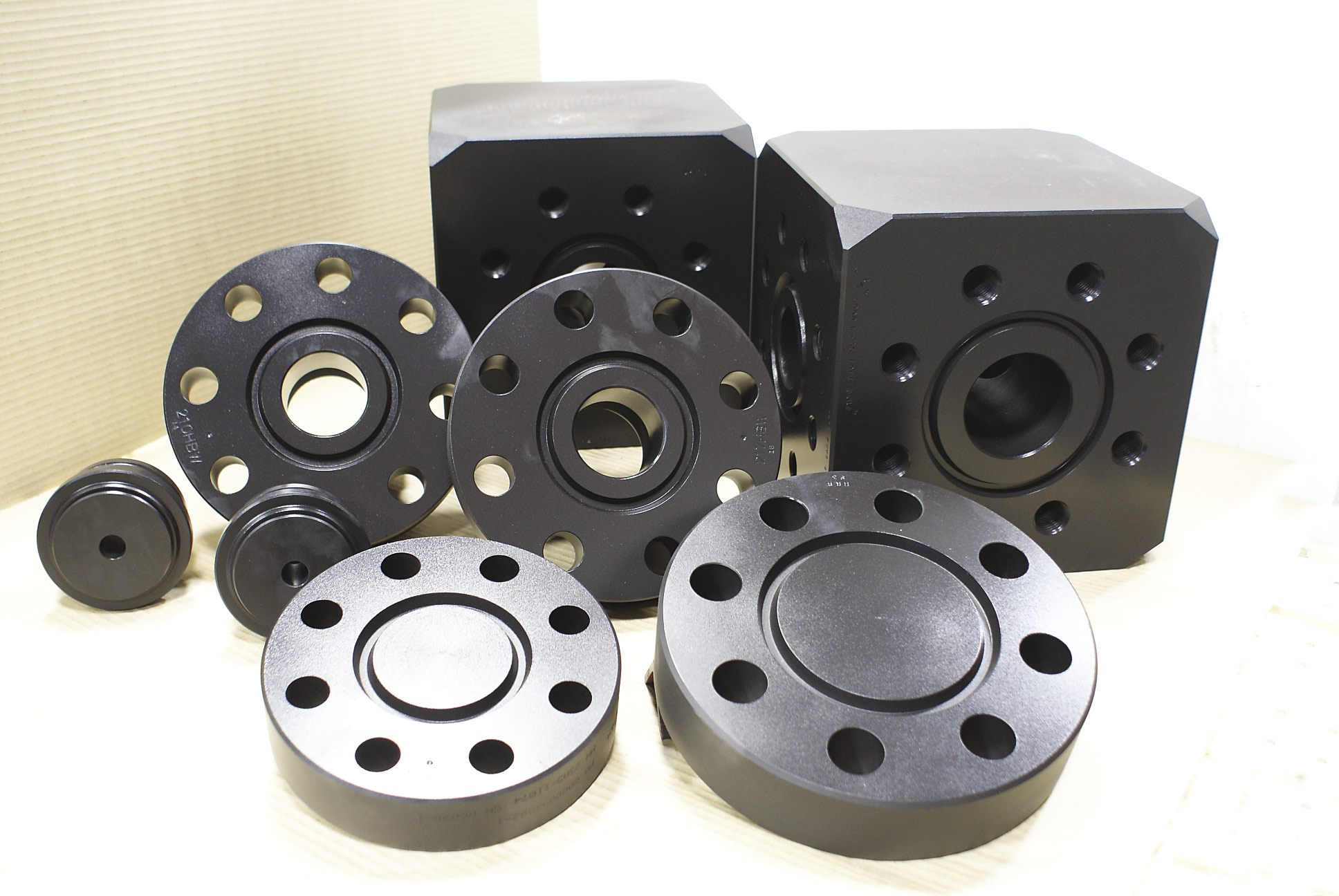

A selection of parts produced by Reinhold Industries. Image courtesy Reinhold Industries.
He added that the repeatability of the HMC enables Reinhold to easily hold part dimensions, and the company is able to spend more time making chips than setting up the machine. “Complex parts are no longer an issue with KIWA’s versatility and quick changeover. Setup used to take us 4 to 5 hours, but now it takes less than an hour.”
Reinhold uses the KIWA HMCs to produce a variety of parts, Klutke noted, such as 15″×15″×15″ crosses and aluminum air-distribution manifolds and mounting supports, while the full B-axis eliminates the use of multiple machines for numerous operations. Parts that previously required five or six operations in multiple machines, lathes and machining centers now run in two operations simultaneously on KIWA tombstones. “They have eliminated the accuracy issues we had when using multiple machines and operations,” Klutke said, adding that run times are shorter as a result.
“Across the board, the KIWA machines have reduced handling and allowed us to achieve, on average, a 20 percent increase in productivity and, in some cases, up to 40 percent,” Klutke said.
