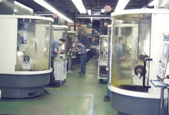

Courtesy of US Tool Group
US Tool Group workers repair cutting tools on Walter CNC tool grinding machines.

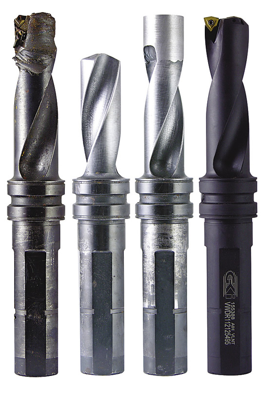

Courtesy of GKI
Even a badly damaged indexable-index drill (left) can be repaired. Regardless of damage, GKI states that it removes the entire damaged section of the tool, adds material congruent with the parent metal to the damaged tool and machines tool features, such as pockets, screw holes and coolant holes, into the tool.

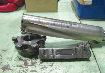

Courtesy of Velan Valve
A selection of damaged indexable tools at Velan Valve suitable for repair.
