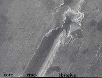

Figure 1: Debonding of the interface between grinding-wheel core and a bonded abrasive. (SEM photograph courtesy of Harry Cai.)
Because it is usually a weak link in the wheel structure, the interface between the bonded abrasive and the core makes safety concerns with superabrasive wheels different from those with solid-bond, conventional-abrasive wheels. Figure 1 shows a scanning-electron photomicrograph of a crack in the bond interface between a bronze core and a diamond-impregnated bronze abrasive. This debonding of the abrasive from the core typically occurs when operational and grinding stresses exceed the strength of the bond.
