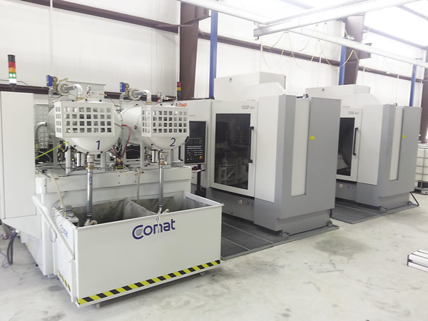

Haas Saw purchased a Comat Model 2F25US-14 filtration and chiller system to achieve a 3µm filtration level for synthetic oil when resharpening carbide-tipped saw blades on its CM 300 and CMF 300 grinding machines from Vollmer of America Corp. Image courtesy Comat Technologies.
