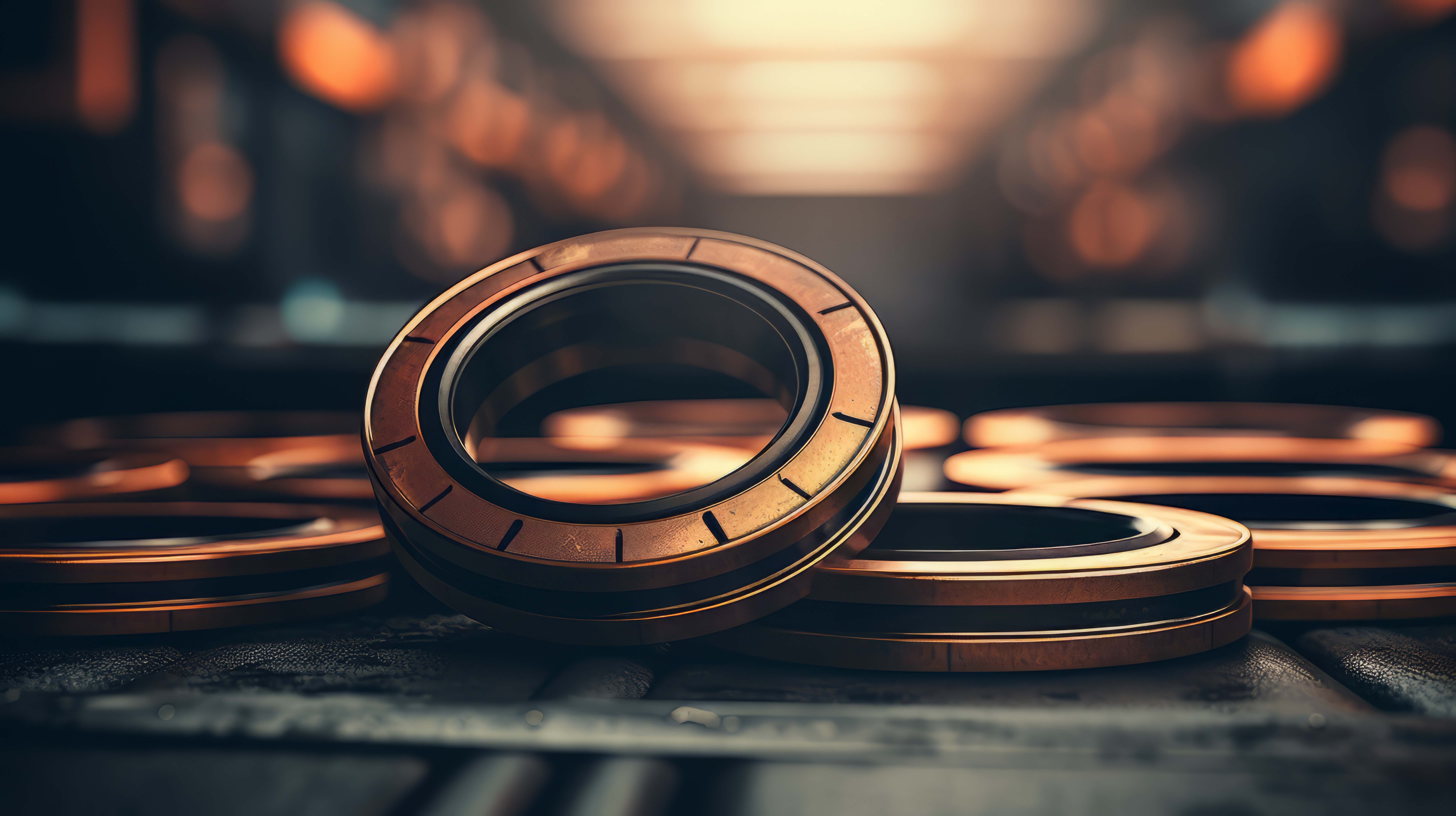

Hydraulic system seals
The most common finishing process for sealing surfaces is grinding.
The most common finishing process for sealing surfaces is grinding. Component geometry, production volumes and component size are going to dictate the process that is used. Surface finish requirements and material properties will dictate the size, shape and type of abrasive wheel that is selected.

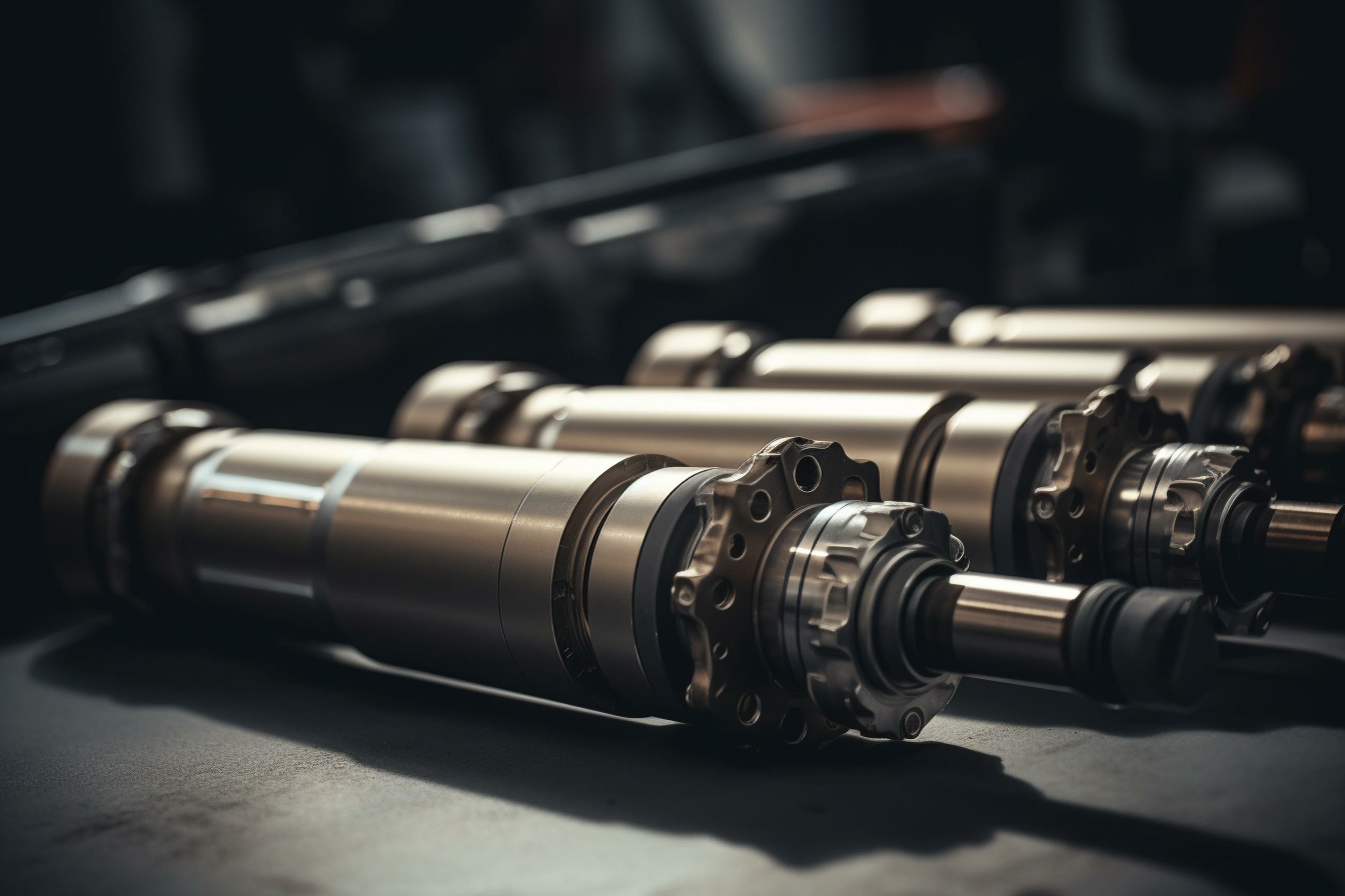

Hydraulic cylinders
In high volume shops centerless grinding might be the first choice for parts like rods for hydraulic cylinders.
Honing is also applicable in all volume scenarios. There are inexpensive manual honing machines available for low-volume applications and there are automated and sophisticated honing machines for high-volume manufacturers. There are variations in machine size and part orientation depending on the application. However, there is little difference in the honing tools and the process. In all cases the parts are held stationary, and the rotating stones are stroked axially to achieve the fine finishes required for sealing.
