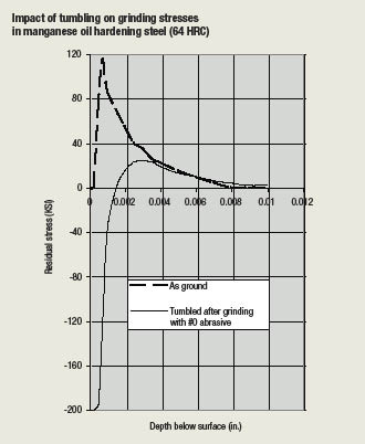

Figure 1: Subsurface stresses through the thickness of the part from grinding and tumbling.

An unseen result of machining and heat treating is the creation of residual stresses. All mechanical chip-producing processes leave stresses in a part’s surface. The raw material has some stresses in it, but stresses from machining can cause a host of issues. First, tensile stresses reduce the overall strength of most parts. These stresses can be quite high, even higher than the material’s bulk strength (Figures 1 and 2).

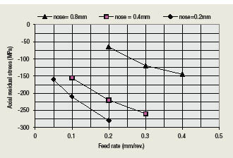

Figure 2: Average axial residual stress as a function of feed rate when turning 34CrNiMo6 steel.
Residual tensile stresses also reduce part life due to fatigue. Repeated cycling of a material, such as back and forth flexing of a wing or slight bending of a shaft as it rotates each cycle, will not cause it to fail if the loads are kept below the material’s endurance limit. However, internal residual tensile stresses can lower the endurance limit below the historical or guidebook value. Figure 3 on page 53 illustrates some endurance limits on 34CrNiMo6 steel as a function of the feed rate. The part will last indefinitely if machined at 0.2 mm/rev. and the stress is kept below about 500 N/mm, but its endurance limit will be below 450 N/mm if the part is cut at a feed rate of 0.8 mm/rev.
Machining-induced residual stresses normally only exist a few thousandths of an inch below surfaces, but that’s where cracks begin and where high energies that are held between grain boundaries and within grains are available for undesirable actions, such as accelerated corrosion or rapid crack extension.

Machining and deburring can introduce beneficial compressive stresses that significantly improve a metal’s normal load carrying ability. Compressive stresses counteract the normally damaging tensile loads. The tumbling processes for deburring and surface finishing, for example, improve the compressive stresses through a gentle but firm peening of the surface as parts tumble against the deburring media. The aerospace industry commonly performs peening with metal shot or glass beads to add compressive stresses. Electrical and chemical finishing processes may remove some of the subsurface stresses, but they do not add any beneficial stresses. It is important when machining and finishing parts to closely control the chemistry, hardness and geometry of the finishing materials to assure consistency.

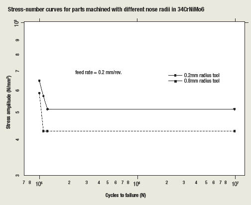

Figure 3: Endurance limit as a function of cutting conditions in 34CrNiMo6 steel.
Proper heat treatment can also reduce harmful tensile stresses in some materials. Many of the military specifications define heat treating steps to control stresses, and most heat treaters have the knowledge to properly address stress concerns.
