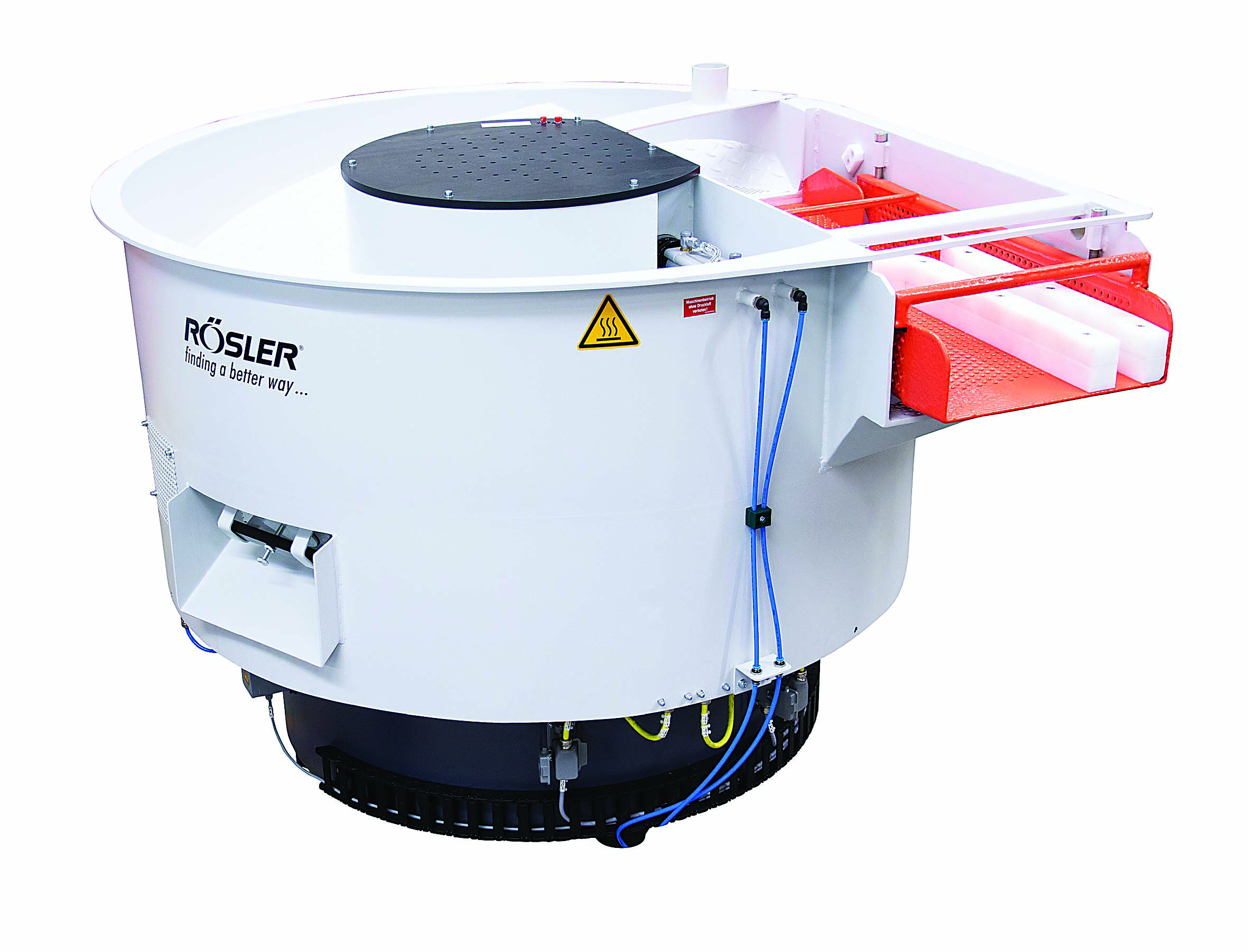

The polishing operation takes place in a new Rösler R 780 EC rotary vibrator. The special shape of the processing bowl creates a gentle, homogeneous flow of the media/workpiece mix, according to the company. This flow ensures that small and delicate, as well as large and bulky, workpieces are polished and separated in an efficient, gentle manner. The same operational benefits also are achieved with a second new rotary vibrator from Rösler, the model R 420 EC. Together with specially selected media and compounds, Ottobock uses this machine for a broad spectrum of applications that range from deburring and edge radiusing to surface smoothing.
The RT 550 Euro-DH rotary dryer from Rösler provides spot-free drying while reducing energy consumption up to 40% compared with conventional drying systems. Image courtesy of Rösler Oberflächentechnik
