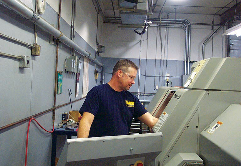

Scott Butts checks the setup of one of TMCO’s Citizen Swiss-style machines.

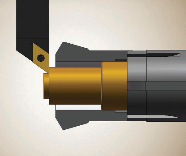

While the guide bushing provides a rigid setup, it requires different machining strategies and tooling than conventional turning operations. A turned diameter usually cannot be pulled back in the guide bushing collet. If this happens, the workpiece can fall out of the guide bushing.
Multiple roughing passes can be performed as long as the length of cut is not greater than the length of the guide bushing—typically ¾ “. Scott Butts, manager, Swiss department for TMCO Inc., Lincoln, Neb., runs many parts that permit multiple passes. When the length of cut increases past ¾ “, things get challenging because the “multiple pass” strategy will cause the workpiece to drop out of the guide bushing. “We cut a number of parts where we take radial depths of cut under 0.2 “,” Butts said. “These turns are possible if the lengths of turn are shorter than the guide bushing. If the lengths are longer, the turn must be done in one pass.”

Multiple-pass turning is possible on Swiss-style lathes only up to a length where the guide bushing still supports the stock diameter. If that length is exceeded, the workpiece will drop out of the guide bushing as shown.

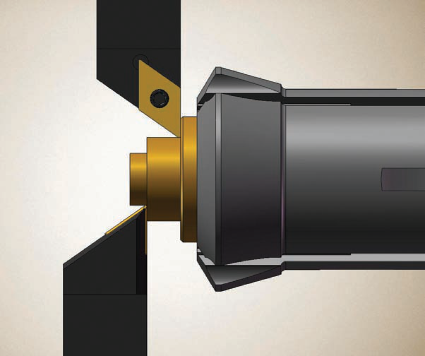

When pinch turning, the upper turning tool makes a rough pass. The lower tool makes a finish pass at or below the feed rate of the roughing tool to assure no interference between the tools.

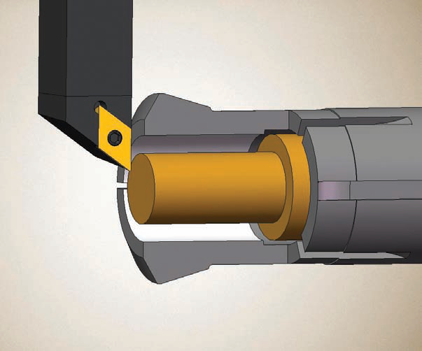

The second pass of a multiple-pass operation. Note that a small chamfer is machined during the first pass to allow the workpiece to reenter the guide bushing. In theory, a turn of any length can be cut with this strategy, but witness lines will be seen at each crossover between segments.
One strategy is to take multiple passes. While that may not be possible in many circumstances, there are several ways it can be done. Some parts can be segmented, a process where multiple passes are broken up into several segments along the length of the turn. Karl Davis, shop supervisor at Midwest Screw Products Inc., Omaha, Neb., did this recently.

Segmenting requires very specific part geometries. Features that break up the turn may allow for segmenting, such as grooves evenly spaced along a turn. The process would be to multiple-pass turn for a ¾ ” length up to a groove, cut the groove and then resume turning for another ¾ ” length to the next groove and so on until the end of the workpiece.
Multiple passes are also possible through pinch turning. In this case, two tools are used: one to cut an intermediate diameter and another to finish. Both tools cut simultaneously, and the finishing tool follows a little behind the roughing insert. While the roughing insert may be programmed to remove slightly more material, it is common for both tools to remove roughly equal amounts of material. This equality helps to balance the load on the workpiece as it is cut, reducing part deflection. Because the DOCs are reduced, feed rates can be increased to 0.005 ipr or higher, making it possible to curl and break the chip.
To pinch turn, the machine must have the ability to have the two turning tools on different slides so two diameters can be turned at potentially two different feed rates. Not all Swiss-style machines have this capability.

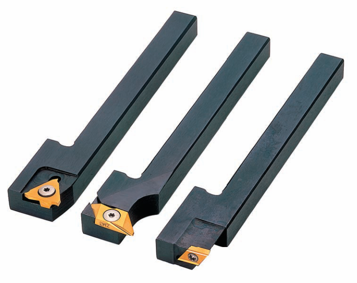

Y-Axis Toolholders
NTK Cutting Tools, Wixom, Mich., has another option for directing chips. Its Y-axis control toolholder line serves to direct chips down into the chip bin as they are created. Turning tools typically control diameters using the X-axis. The NTK toolholders turn the insert so it is oriented along the Y-axis.
Swiss-style machines are often used gang style. All the turning tools are lined up along the Y-axis. A tool call in the program moves the Y-axis to position the tool on centerline, but because the machine has a Y-axis, a Y-axis toolholder takes advantage of the Y-axis. If you think of standard turning tools as being at 0°, the Y-axis tool is positioned at 90°. A standard turning tool is moved in the X-axis to control the cutting diameter. Y-axis tools are programmed in the Y-axis. From this position, the insert is facing down into the chip bin, which causes the chips to be directed down and away from the workpiece and tool.
Courtesy of NTK Cutting Tools
Y-axis control toolholders from NTK Cutting Tools. In addition to front turning tools, grooving and back turning tools are available in this type of configuration.
These toolholders have one additional benefit. The inserts are more accessible to the machinist. Because cutting tools are often positioned close to each other in a Swiss-style machine, it is often difficult to get access to index inserts without taking standard toolholders out of the gang. Because Y-axis toolholders position the insert face down and away from the adjacent turning tools, it is much easier to put a wrench on these toolholders to remove the insert.
