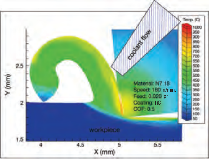

Titanium is a poor heat conductor, so only about 25 percent of the heat in the cutting zone—which can be 1,000° C or hotter—is transferred to the chip. Compared to steel, only one third of the heat is transferred. Therefore, coatings such as aluminum titanium nitride, titanium carbonitride and titanium silicon nitride—generally in a multilayer configuration—create a heat barrier to extend tool life without altering edge sharpness by being too thick.
According to Ravi Iyer, senior engineer in Kennametal’s Product Engineering Group, a physical vapor deposition coating is desirable for milling titanium. He noted that a PVD coating is more effective than a CVD one in a wet environment, which is highly recommended because of titanium’s low thermal conductivity and to minimize the risk of igniting titanium chips—a fire that’s difficult to extinguish.
In addition, a PVD coating exhibits a compressive residual stress state, which is well suited to the thermo-mechanical load cycling caused as the milling inserts enter and exit the cut, Iyer explained.
Titanium can be milled with uncoated tools, but modern coating processes have overcome any issues end users had with coatings, according to Iscar’s Carrington. “If you’re running an uncoated product today, by and large you’re leaving money on the table,” he said.
In addition to providing a heat barrier, a coating provides lubricity. “Titanium is starving for lubrication, and anything a little slicker is going to perform better,” Carrington said, noting that he feels TiCN provides more slickness than TiAlN.
Coolant also provides the lubricity titanium craves, but only if the coolant concentration is high enough. According to Carrington, machining titanium is significantly more effective when a 14 percent coolant concentration is applied, which compares with a 5 to 7 percent concentration when machining multiple materials and 9 to 11 percent for high-temperature alloys.
Carrington recalled how he helped achieve acceptable cutting speed and tool life for one customer’s titanium milling application, but on the next product run received complaints about the endmills. After examining the tools to make sure they weren’t ground incorrectly and reducing cutting speed by 30 percent, tool life was still about half of what it was initially. Convinced the tools were the problem, the customer switched suppliers only to find that the original endmill outperformed the others he tried even at the reduced parameters for the original. On the third product run, the customer revealed the problem was eliminated. “I said, ‘OK, I give. What’s the deal?’ He said, ‘We changed the coolant and percentage.’ Same part, same machine, same cutting tool, same cutting parameters—dramatically different results,” Carrington said.

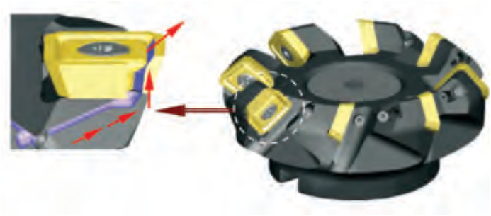

How coolant is directed to the tool/workpiece interface is also critical. External coolant systems still might be the primary method, but high-pressure/increased flow-rate, through-the-tool coolant systems are becoming more popular. “More than any other material, the use of high-pressure coolant is very beneficial when cutting heat-resistant superalloys like titanium,” Standridge said. “High-pressure coolant directed properly into the cutting zone creates a separation point, so there’s less contact time between the titanium chips, the workpiece material and the cutting edge.” That reduces edge line wear.
Courtesy of Sandvik Coromant
The challenge in milling is to deliver the proper flow rate to achieve high-pressure levels because a multiple-flute mill has numerous coolant holes, which creates more area for the coolant to fill. To address that, Sandvik Coromant developed a jet nozzle system in which threaded nozzles are positioned in coolant holes to restrict flow at the cutting edge and increase pressure, similar to placing your thumb over a garden hose.
The challenge in milling is to deliver the proper flow rate to achieve high-pressure levels because a multiple-flute mill has numerous coolant holes, which creates more area for the coolant to fill, Standridge noted. To address that, Sandvik Coromant developed a jet nozzle system in which threaded nozzles are positioned in coolant holes to restrict flow at the cutting edge and increase pressure, similar to placing your thumb over a garden hose, he explained. (See video illustration above.)
The goal is to achieve a coolant pressure of about 1,000 psi, or 70 bar, but an adequate flow rate is also important, Standridge noted. “We typically like to see pumps with a minimum flow rate of 15 gpm.”
Although high-pressure coolant’s quenching action helps cool the cutting zone, it also assists in mechanically forming and evacuating chips. To enhance those coolant functions, Kennametal introduced Beyond Blast tools with through-coolant inserts to channel fluid directly to the milling cutter/ workpiece interface. (See illustrations above.)
“Coolant forces are getting under the chip and directing it away from the cut, whereas the coolant is coming from outside the cutting zone and pushing the chip back into the cut in a traditional coolant system,” said George Coulston, Kennametal’s vice president of Innovation Ventures. “Beyond Blast pushes chips out of the cutting zone.”
Extending tool life is one of the main benefits of reducing cutting zone temperature. “By having more efficient coolant delivery, we can lower the temperature at the tool/workpiece interface,” Coulston said. “Carbide’s strength deteriorates as the temperature increases.”
