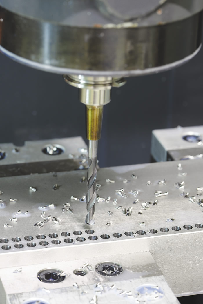

When tapping medical parts, two words come up repeatedly: small and challenging. Small is for the tiny size of many medical parts, and challenging is for the difficult-to-machine materials from which the parts are often made.
Developing strategies for tapping medical parts, then, typically involves many factors, including the cutting tool geometry, machine capability, toolholder, metalworking fluid and the parts themselves. Medical parts that are tapped include implants, such as hip and knee replacements, and surgical instruments.
Again, small is one of the operative words. "Typically, there are few medical parts that are going to need a tap over ½", and most of them need a tap under ¼"," said Ed Goodman, application specialist for OSG Tap & Die Inc., Glendale Heights, Ill.
Key medical part materials include medical-grade stainless steels, titanium and cobalt chrome. Most tap manufacturers have a product line specifically designed for each material. "When you talk about medical parts, some made from titanium might require a totally different tap than those made from stainless steels," Goodman said.

The solution is sufficient clearance. "A tap designed for titanium is going to have extra back taper, taper from the chamfer or the cutting edge to the back of the thread section. This provides the clearance necessary to successfully tap titanium," Goodman explained.
"With that back taper on the tool, the collapsed titanium does not actually make contact with the back of the tool," he continued. "The chamfer on the front of the tap is what is cutting or forming the thread. Adding back taper does not influence the cutting properties of the tap. It may make the tap a little weaker, but it eliminates the issues involved because of the 'springiness' of titanium."
If the titanium does clamp around the tap and it is not able to rotate, the tap may break. Because tapping is often one of the final operations, a shop already has a lot of time and money invested in the part. If the tap breaks and can't be removed from the part, the part ends up being scrapped.

Chip packing can cause tap failure and degrade thread quality. Stainless steel produces stringy, hard-to-break chips. Titanium does not easily break into manageable chips either, while cobalt chrome does produce smaller chips.
However, when tapping through-holes, chip management can be simplified by applying a spiral-pointed, or gun-type, tap. That tool pushes the chips ahead of the tap—it "shoots" the chips forward. For a blind-hole, a spiral-flute tap pulls the chips back through the top of the hole.
The flute form is key to chip evacuation, according to Precision Dormer's Maxey. "Our taps have a three-radii flute profile, which provides a constant rake along the flute length, leading to better chip evacuation and more accurate thread form."
