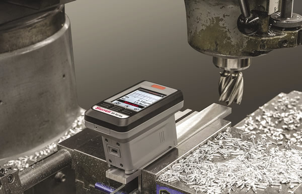

A Starrett SR series roughness tester is used to measure the finish of a machined surface. Image courtesy L.S. Starrett.

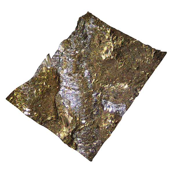

Measured using the Contour Elite 3D optical microscope from Bruker, this 3D image of a copper ring shows a color image overlay. Image courtesy Bruker Nano Surfaces.

Adding to the parameter soup is the letter S, such as Sa, the analogous parameter in the 3D space for the 2D Ra. When using a noncontact, optical device to enable 3D measurement, Cohen said end users see the entire surface relative to the part rather than a line trace across the surface. "Like one person said when I was demonstrating this equipment, he could finally see what he was measuring."
Nonetheless, the adoption of 3D measurement is somewhat slow—but usage is growing, according to Bruker's Novak. "A lot of people still make do with 2D parameters, or profile-type data, but are finding they can't get to the root cause of a performance problem," he said, noting that drives manufacturers to start looking at noncontact, or larger-area, measurement.
Novak added that optical surface measurement systems provide results that are independent of the operator. "Because you're measuring over a wider area, you're not so critically tied to the position of the stylus trace," he said.

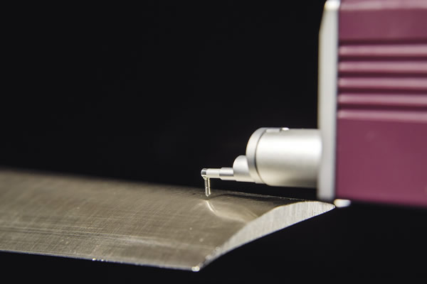

For the majority of end users who measure surface roughness, Butler said Starrett offers three main stylus-based roughness testers: SR160, SR300 and SR400. While the diamond stylus is integral on the SR160, the base model, the styli on the SR300 and SR400 are exposed and contact the surface being measured. This contact provides the user with more information and enhanced analysis of the results, according to Butler. The radius of a diamond stylus is from 5µm to 10µm, and it is critical to maintain the integrity of that sensitive component.
"Probably the most common issue we have is a bad stylus that needs to be replaced," he said.
Another way to distinguish stylus-based surface measurement instruments is whether they are skidded or skidless. Mitutoyo's Carravallah explained that skidded units are primarily for measuring flat surfaces while skidless ones, which read the high-frequency wavelength for roughness and the low-frequency wavelength for waviness, are also suitable for surfaces with radii and contours. "Wt is a waviness parameter," he said. "Once the Wt parameter comes out, we know we are in a skidless application." In addition, Mitutoyo's skidded instruments have a Z-axis stylus travel of only 360µm, compared to 800µm for its skidless instruments.
