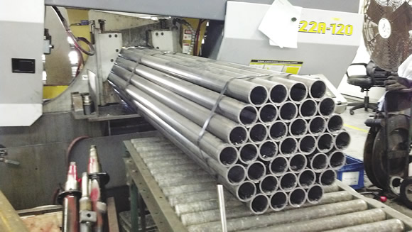

Vibration from poorly nested workpieces limits bundle cutting performance. Generally, workpieces are not perfectly straight and do not have perfectly identical dimensions, and therefore are prone to move within the stack. “If you have a bundle of 1 “-round workpieces five wide and five high, the chance that all 25 of those are the exact same size is pretty small,” Finklea said.
To minimize movement and vibration, workpieces must be tightly secured. In addition to the side vises already on the bandsaw, the most effective method to hold material in place is to use a top clamp, commonly referred to as a bundle cutting attachment, an option on most production bandsaws. The side vises maintain the position of the material and the top clamp applies down pressure, keeping an individual piece from popping up and out from the bundle.
Even with a top clamp, there is a chance for round workpieces to start spinning. “With round materials, if you have one in the middle that is on the smaller side, and the others around it are bigger, the middle piece is floating. Even though you have clamping on all sides, there is nothing holding that smaller piece and as soon as the blade hits it, the piece starts to spin,” Finklea said. “We tell customers the only way to guarantee that a piece won’t spin is to tack weld the ends of the pieces—put a dot of weld where the pieces are touching, just enough to keep them together so the one in the middle will not spin.”

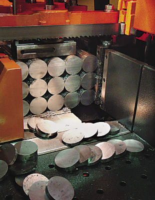

For bundle cutting, the most effective cuts are those made in solid bars using bi-metal blades. When blades continuously cut solid material, stresses on the teeth after initial impact tend to be consistent. Bundle cutting solid materials is like cutting one big workpiece, noted Saxon.

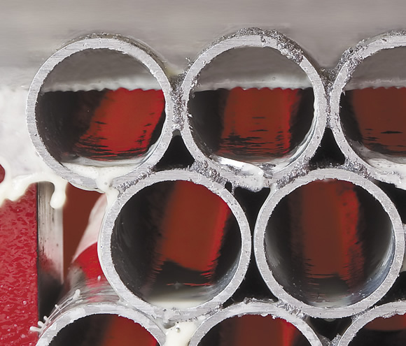

Conversely, cutting tubing typically abuses the blade because the teeth must enter and exit two walls. These sudden changes increase vibration and workpiece movement, stripping the teeth from the blade. When multiplied by the number of tubes in a bundle, it is easy to see how blade life would be reduced. According to Finklea, this reduction could be as much as 25 percent.
“That constant impact of leaving and entering a cut in interrupted sections does have an effect on the cutting edge of the tooth and you are going to see a little lower blade life no matter the material,” said Gene Ramsdell, manager of North America saw R&D for bandsaw blade manufacturer The L.S. Starrett Co., Athol, Mass.
Having an application-specific tooth design to address the problems inherent in interrupted cutting helps extend blade life.

Another issue with bundle cutting tubing is pinching the blade. “Pinching is basically the result of the workpiece moving in the bundle and compressing against the side of the blade while it is being cut,” Ramsdell said. “In many cases, it will physically stop the blade in its tracks, strip teeth off or cause the blade to break.”
The most common way to prevent pinching is to apply a blade with a heavier, wider tooth set. “This creates a wider kerf so if the material does move, it may not be enough to cause the blade to pinch like a conventional set blade,” Ramsdell added.

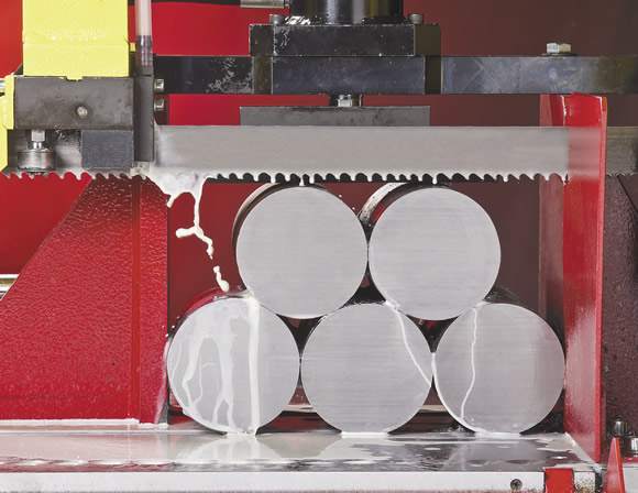

Chip removal is another challenge with bundle cutting. “As the blade takes a chip out, a lot of times the gullets just load up because there is no place for the chips to go when you are inside of a bundle,” Saxon said. “If the gullets are full of chips and the blade is still trying to cut, it can cause chip welding and the blade teeth can strip.”
Also with tubing, chips collect in the hollow of each tube in the bundle and cutting through those workhardened chips decreases blade life. Therefore, flood coolant is essential to flush chips but bundle cutting tubing with flood coolant is usually messy. “As you cut through the bundle, as soon as the coolant hits the tube, it starts filling the tube instead of continuing on the blade or continuing through the cut,” Finklea said. “Coolant tends to travel up those tubes or even into the spaces between round solid bars to a certain extent and out the ends.”

With bundles, cutting tends to be the easiest part. “The biggest issue with bundle cutting is material handling,” Finklea said. “On the inbound side, that bundle may be in a big stack. You have to break it apart, reshape it and put it into your bandsaw. And on the outbound side, the customer has to deal with those cut parts.”

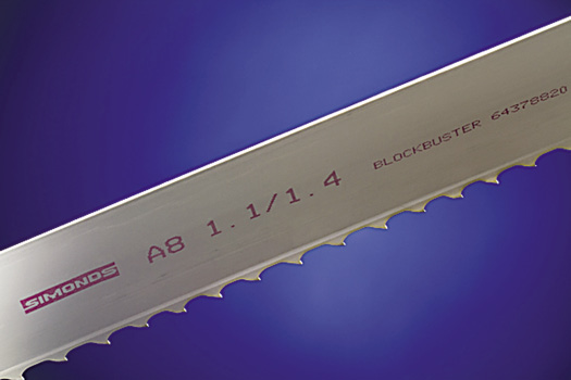

Courtesy of Simonds International
Simonds Blockbuster bimetal blade can be used for large bundle cutting of solid bars.
