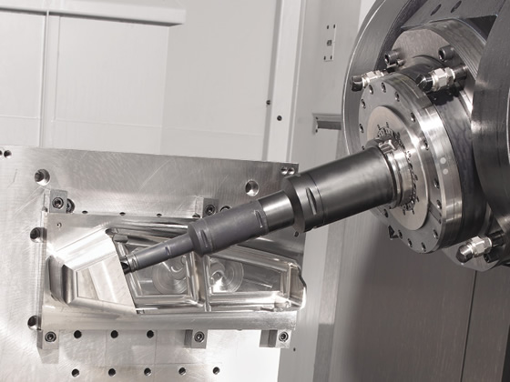

Courtesy of Makino
A titanium workpiece is machined in a Makino T4 5-axis HMC, which includes an active damping system.

Walker pointed out that the first requirement is to design a machine tool for low-frequency machining, primarily milling. That’s because end users typically cut the more difficult-to-machine titanium grade at low rpm while hogging as much material as possible to boost productivity and profitability. How low is low? Mitsui Seiki, for example, stated a 1 “-dia., 4-flute endmill would run at about 90 rpm, and conducted tests machining 5553 at 67 rpm with a 3½ “-dia., 6-flute cutter. The low spindle speed produces a low-frequency vibration in the machine structure, potentially exciting the structure’s natural frequency in low-frequency ranges and causing chatter.
Machine builders perform tap testing to determine a machine’s natural frequencies by tapping structural portions of the machine tool and measuring the structure’s excitation frequencies. “Any kind of mechanical system has natural frequencies at which it tends to vibrate,” explained Mark Larson, manager of titanium process development for Makino Inc., Mason, Ohio. “Different machines and different spindles have different points that are natural frequencies. Those are the areas you want to stay away from.”

On its NH series HMCs for difficult-to-machine materials, such as titanium and nickel-base superalloys, DMG/Mori Seiki’s Wallace noted that the spindle has a passive damping system to change spindle frequency as needed during heavy cutting. In addition, an active damping system is in development.
Larson said Makino’s “active damping changes the amount of friction in the ways and therefore absorbs more or less of the vibration, depending on how things are changing dynamically with the machine. The machine quickly adjusts to vibration picked up by the monitoring system.”
