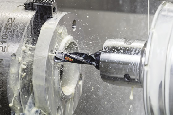

![APX01sharpened.tif](/sites/www.ctemag.com/files/article_images/APX01sharpened_opt.jpeg)
Courtesy of Allied Machine & Engineering
The Allied APX modular drill accepts Allied Machine’s GEN3SYS or T-A pilot inserts for various drilling applications.

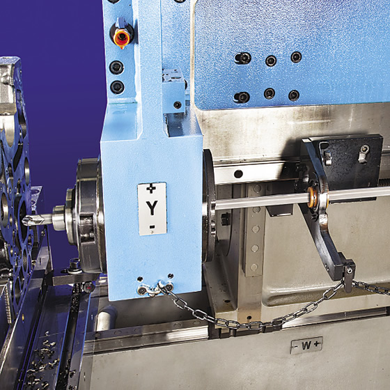

![130986.tif](/sites/www.ctemag.com/files/article_images/130986_opt.jpeg)
Courtesy of Sandvik Coromant
Sandvik Coromant recommends monitoring tip wear on modular drills, like the CoroDrill 870 shown here, to avoid tool breakage and prevent crashes.
