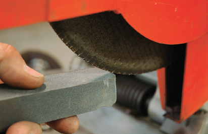

- Disc dressing: Dress abrasive cutting discs with a stone to maintain free cutting action. Using a stone is a trick that works to keep cutting discs hum-ming along. In general, these wheels break down quickly enough that fresh abrasives are easily exposed. The thicker the cutting disc, the better this stone technique works, es-pecially when you have a broad cut in comparison to the width of the abrasive disc. Use this technique when making broad cuts in tough-to-grind workpieces and finishing materials that tend to load a wheel, such as stainless steel or aluminum. A quick touch-up with a dressing stone sharpens a disc in a flash.

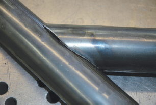

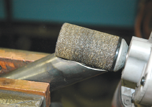

- Tube fit up: You can use a round grinding stone to make perfect joint fit ups in round tubing and pipe. These round grinding stones are available in several diameters. If I am fitting tubing with an odd diameter, I dress the round stone with a diamond dresser in the lathe until it closely matches the tube diameter. Good welding can only come after good fit up. This is one way to make the joints fit with a minimal gap. Use this method for off-angle connections or tube sizes that your notcher cannot do.

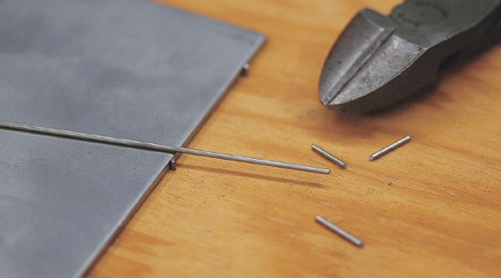

- Graining nails: When you need to add a linear grain finish to stainless steel sheet, it can sometimes be a pain to clamp the sheet so you don’t get funny run-off marks or stops and starts where the clamps were. One trick involves what I call “graining nails.” I like to use a piece of plywood to grain flat sheets manually. The plywood should be a little wider and a little longer than the sheet on which you are working so you can clamp it securely. Graining nails are made from snipped-off pieces of stainless steel filler rod for stainless sheet and steel filler rod for steel sheet, and look like small finishing nails. Using like materials prevents contamination of the sheet from metal transfer. Ham-mering a few of these nails around the perimeter secures the sheet during graining without using clamps.

High-quality welding can only come after high-quality fit up.

Graining nails are made from snipped off pieces of steel or stainless steel filler rod and look like small finishing nails.

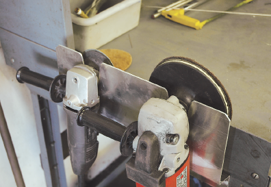

- Grinder holders: You can tell if somebody knows how to grind by the way he lays his grinder down. The goal when grinding is to keep the disc as flat as possible for the life of the disc. A warped disc makes for crappy grinding and rubbery arms at the end of the day. An effective way to store a grinder is to make a holder that protects the abrasive disc from damage. CTE
