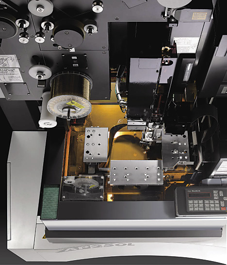

EDMs that use an oil-based dielectric instead of water work well with fine wire and carbide workpieces. Courtesy of Sodick.
Courtesy of Sodick

Both round and V-shaped wire guides are used in EDMs. Sodick's Thomas typically recommends V-shaped guides for wire 0.001 " in diameter or finer and round guides for anything larger.
There are disadvantages with the V-shaped guides, especially in the higher-speed wire EDMs, according to Thomas. "When the round wire sits in a V-shaped guide, the support area between the wire and the guide itself is only a 2-point contact. In the case of round guides, the support area is 360°, which is critical for achieving cutting precision." Not everyone agrees with Thomas, however, that V-shaped guides are less accurate.
