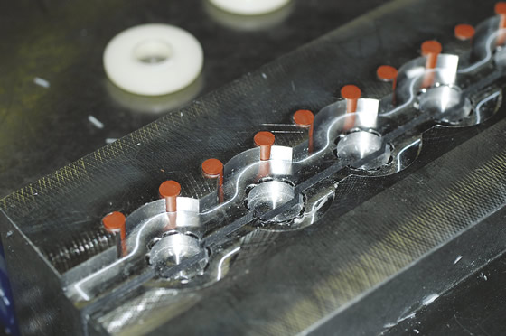

Pieces of O-ring cord stock added to soft jaws is a neat workholding trick.

■ Everybody seems to have trouble holding multiple parts in a single vise to take advantage of the speed of a CNC machine. Cut soft jaws to hold the parts and add some pieces of O-ring cord stock. The O-ring intrudes into the part pocket by 0.010″, compensating for any size variation in the individual parts. Drill the O-ring holes before cutting the pockets.
■ Another way to use O-rings to help hold parts involves cutting a standard dovetail O-ring groove into the movable soft jaws of the vise. The bit of O-ring sticking out above the surface grips all the parts securely for a facing operation. You can use a piece of Delrin rod instead of the O-ring.

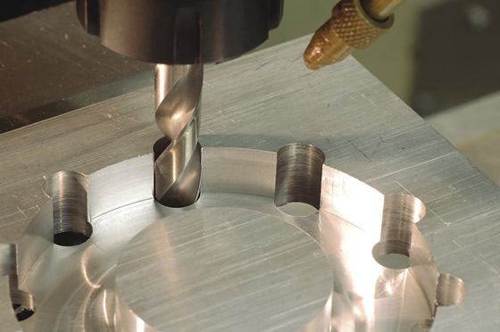

■ For one or two parts, you can run a second drill cycle after partially pocketing through drilled holes. This will reduce subsequent deburring operations. The vertical burrs on the hole edges are difficult to manually deburr. If you have time, you can apply a small endmill and radius these edges.

For producing one or two parts, run a second drill cycle after partially pocketing through drilled holes.

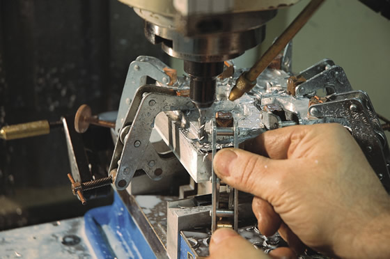

■ For parts without interior holes to hold them down, use a technique I call “musical clamps.” This requires operator intervention at critical times to move clamps and holding fixtures. It helps if your CNC allows a manual spindle stop with feed hold from the operator station.

The “musical clamps” technique requires an operator to move clamps and fixtures at critical times when machining parts without interior holes to hold them down.
