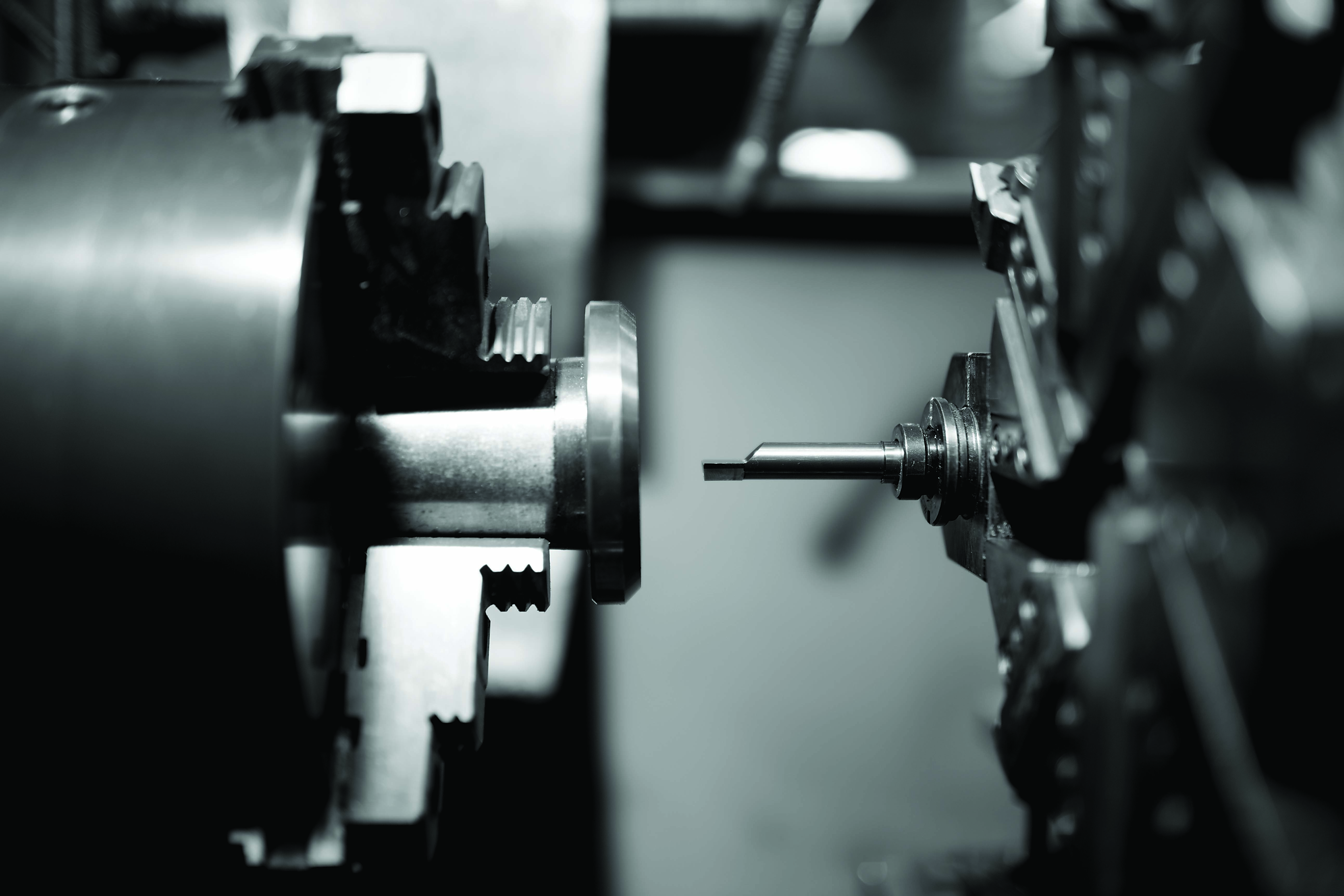

One of the challenges when boring workpiece materials susceptible to workhardening is recognizing whether the prebored hole is already workhardened.
“The biggest issue is that most of the time the people who are boring that workhardened material don’t realize it,” said Harvey Patterson, product development manager for Scientific Cutting Tools Inc., Simi Valley, Calif.
As a result, they typically program the machine to bore with parameters appropriate for a metal in a nonhardened condition, such as soft steel, and experience degraded tool life, he added. However, the hole may have already workhardened because it was produced with a drill that was dull or inadequate for the job, and the end user troubleshoots the wrong operation.

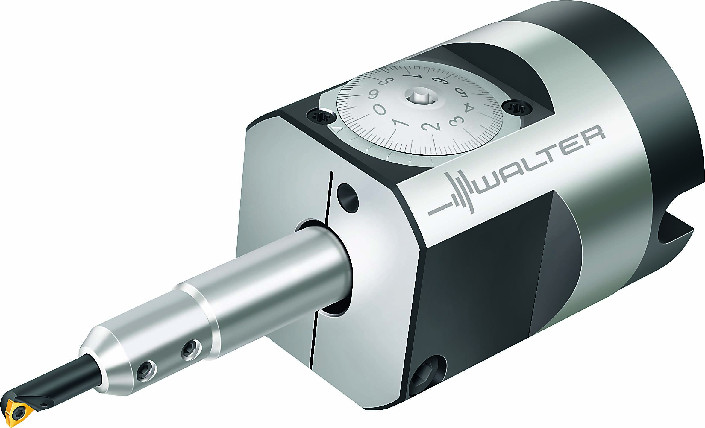

When boring a workpiece that tends to workharden, Walter recommends applying a tool with a sharp edge radius and sharp corner radius to reduce the radial cutting force and take a DOC that is well-past the corner radius. Image courtesy of Walter USA.

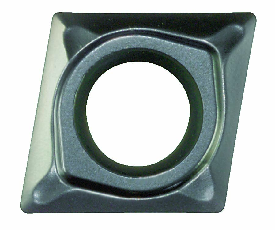

To prevent workhardening while effectively boring a hole, Morrett said Allied offers an ISO-standard insert with a positive cutting edge geometry that gets underneath the chip to shear it and reduce the amount of heat generated during boring.
“This geometry is a good starting point for materials that are likely to workharden and is available in three different ISO sizes” he added.

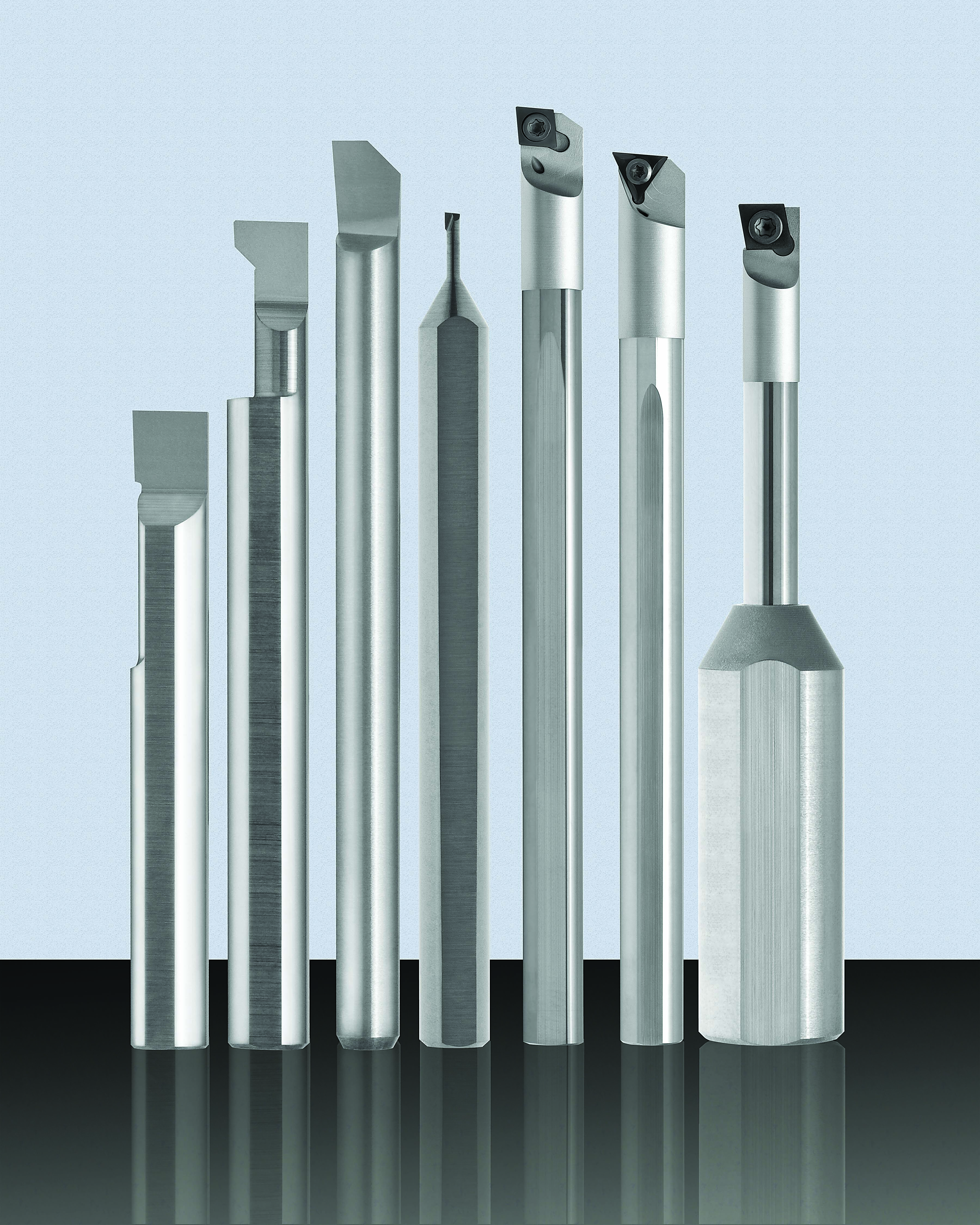

Scientific Cutting Tools offers a range of boring bars. Image couresy of Scientific Cutting Tools.
