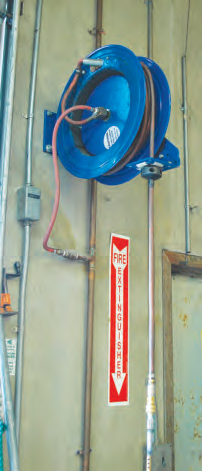

Hose reels help store air lines.

Hose reels are great for neat, clean storage of air lines. Put two at opposite ends of the shop and have them slightly overlap in length when the hoses are fully extended. Don’t forget to put a universal female coupler on the end. Also, be sure to include a valve right before the hose reel so you can service the reel.
Don’t let the hose slide through your bare fingers when retracting the hose reel. Razor sharp chips get stuck in the hose surface and will slice your hand. Instead, keep your hand on the quick disconnect at the end. Pain awaits the daydreamer or unwary with a bad gashing.
