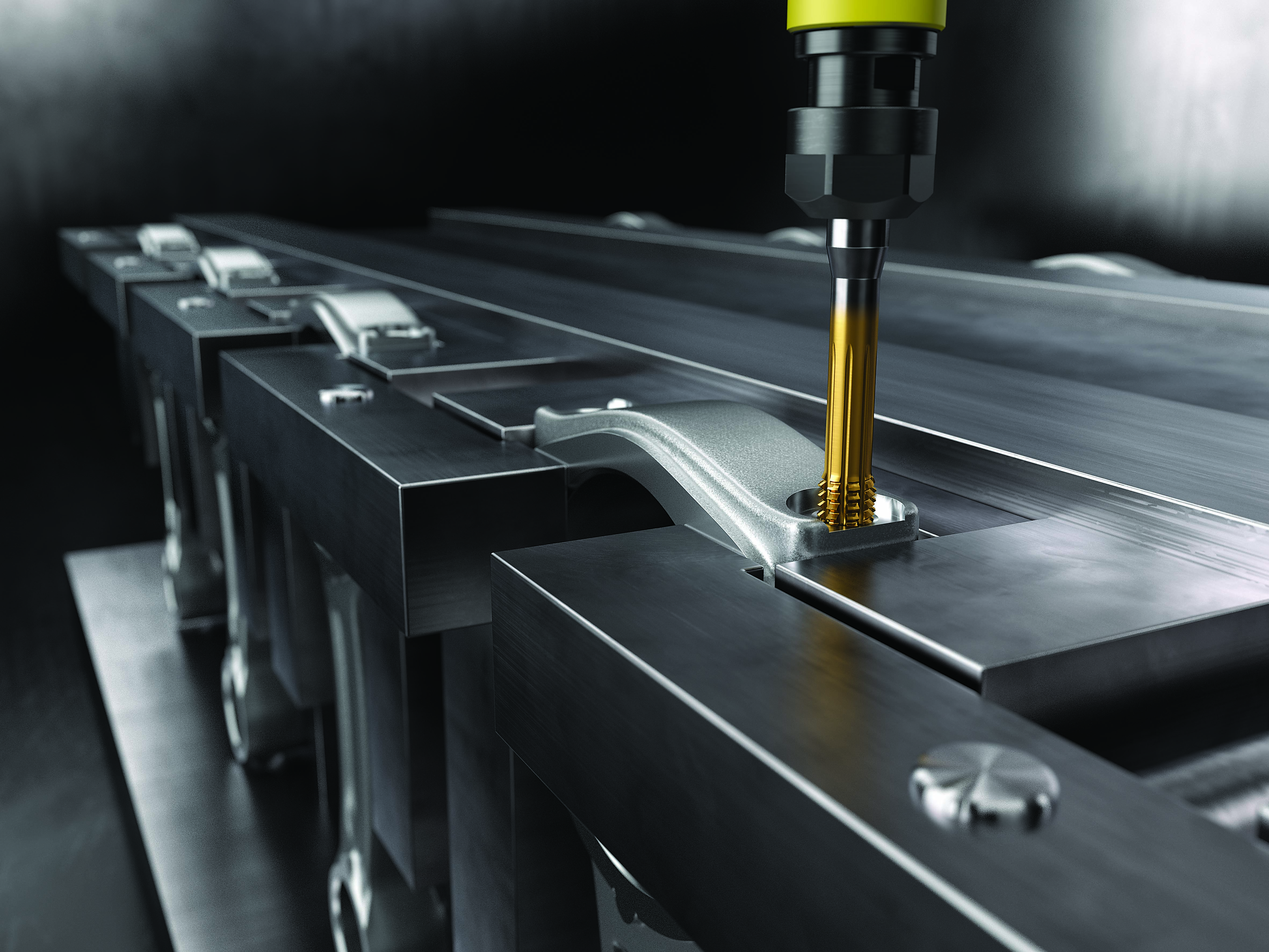

Minimize wear on tools and improve accuracy when tapping hard materials with specialized tap drivers like this CoroChuck® 970. Image courtesy of Sandvik Coromant
Shops will also need to take much greater care with tool selection, hole preparation, lubrication and more to meet those challenges.

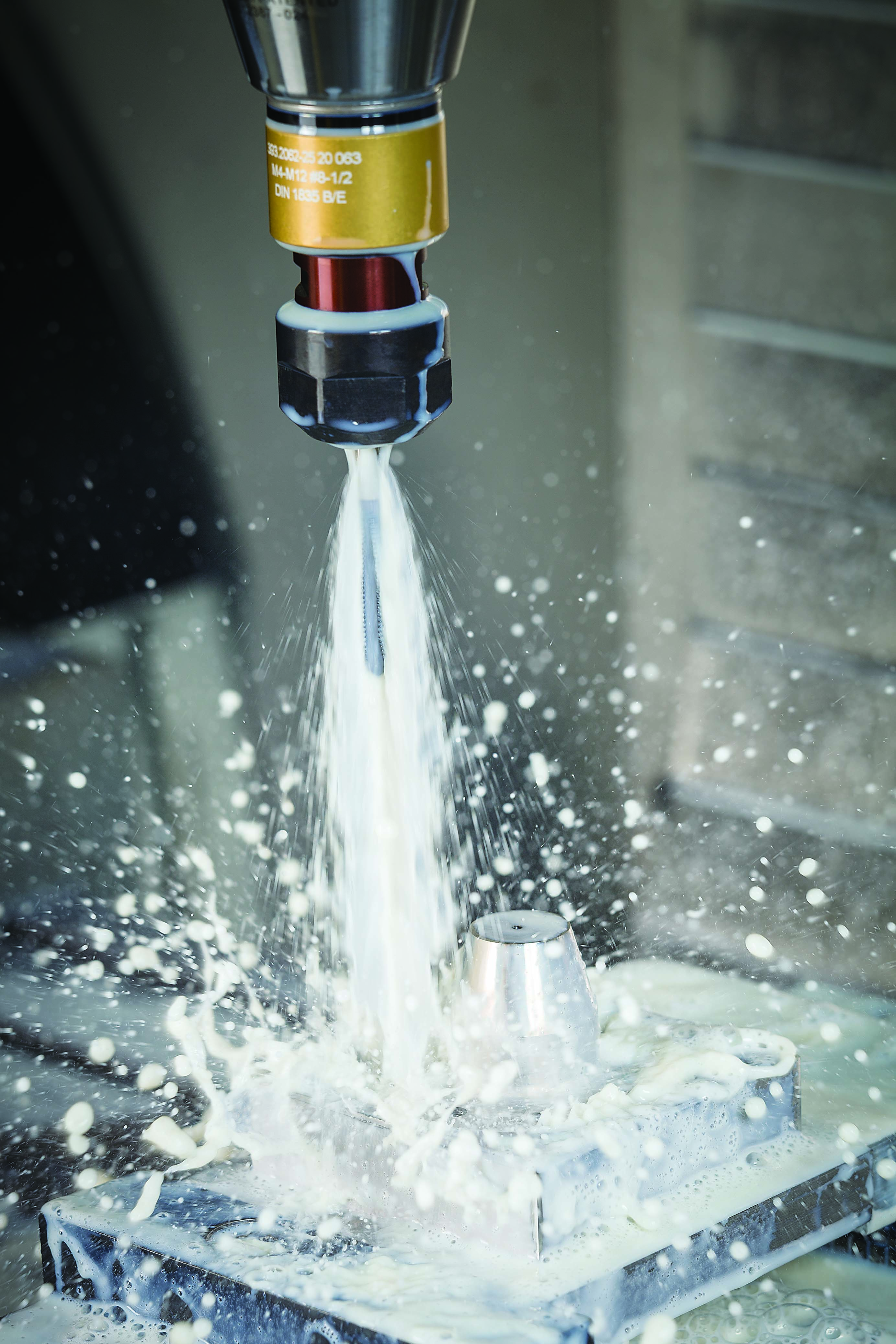

One of the most important factors to successful tapping is lubrication. Unfortunately, it’s also one of the most overlooked aspects of the operation. When errors start occurring in the tapping process, one of the first places to look is at the oil concentration levels in the coolant. In many cases, the concentration will be too low.
When tapping hard materials, using straight tapping oil is ideal. This may be possible if tapping is the only operation you’re running, but in most applications, shops are using a CNC machine for all kinds of operations, and they can’t run straight oil. Instead, they’ll need to run a water-soluble lubrication with the highest possible oil concentration. While standard tapping operations may run with 5% to 7% concentration, it’s best to push that up to at least 10% or 12% with harder materials.

One of the most important factors to successful tapping is lubrication. Shops need to run a water-soluble lubrication with the highest possible oil concentration when tapping hard materials. Image courtesy of Sandvik Coromant

Another important way to minimize wear on your tools and improve accuracy when tapping hard materials is with specialized chucks or tap drivers. Even though many machines today have rigid tapping cycles for secure tapping operations, those machines and their servos wear, which in turn can create a slight mismatch between the program feed and the actual feed.
To address this, shops can use toolholders for synchronized tapping that have a special coil built inside to provide micro compensations for inaccuracies in the machine. This improves tapping precision by providing accurate depths, and it reduces thrust force on the tap flanks. These tap drivers can be used in any tapping operation to minimize risk of oversized threading, improve process security and extend tool life.
