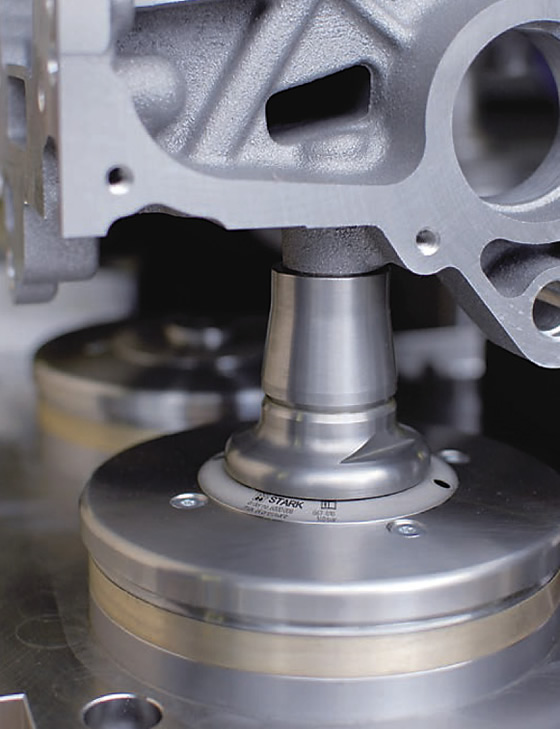

Another thing to consider is skipping the fixture altogether. "When zero-point first came out, the idea was to use it together with a vise or chuck so you could get it off the machine quickly," said Kurt Zahn, key accounts manager with Carr Lane Roemheld Manufacturing Co., Ellisville, Mo. "But probably 50 percent of the shops we work with today attach the nipple directly to the workpiece itself, either to some sacrificial material that is removed in a secondary operation or by bolting it to an existing datum—a threaded hole, for example."

A clamping stud attaches directly to a part, allowing the least-intrusive fixturing possible. This example utilizes a floating zero-point chuck that "finds" the position of the fourth support, effectively eliminating the distortion that commonly occurs when clamping thin-wall parts.
The pull studs, or nipples, Zahn explained, cost around $100 or less and can be removed after machining for reuse. Carr Lane Roemheld Manufacturing is a joint venture of Römheld GmbH and Carr Lane Manufacturing Co. that produces hydraulic clamping and quick-change tooling.
