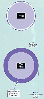

Tolerances have become so tight that, in many instances, the subtle effects of temperature have become significant. In fact, thermal expansion of part features during the production and post-production processes can now exceed the total tolerance (Figure 2). However, since the effects of temperature are so subtle, and the eye cannot discern changes in dimension that are measured in microns or tens of thousandths of an inch, it is easy to overlook this phenomenon.
Tolerances Feel the Heat
Figure 2: With temperature variation, the thermal growth of parts can sometimes exceed the total tolerance specified for a feature dimension.

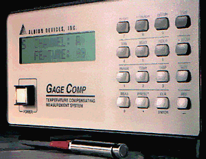

These systems provide users with an economically priced method for minimizing thermal errors that can arise when manufacturing high-precision parts. They sense the temperatures of the key elements of a measurement system—the workpiece, gage, and setting master—calculate the amount of thermal error in that system, and output a correction signal. That correction, or compensation, can be applied automatically to a precision gage so that the measurements taken reflect true dimensions—those in which the elements are held constant at the international reference temperature of 20° C.
A temperature-compensation system consists of a microprocessor-based controller equipped with custom-designed temperature sensors and a selection of I/O ports. It can communicate with almost any electronic gaging system via an analog or digital interface. The device’s sensors attach to the gage fixture to monitor the temperatures of the part being measured, the gage fixture, and the calibrating master or masters.
A temperature-compensation system can be programmed to take into account the effective coefficients of expansion of the part, gage, and master. During measuring operations, the system continuously senses temperature variations, then computes and sends a correcting signal to the gage. The gage then eliminates thermal errors and displays the correct measurement (Figure 3).

Environmental controls such as air conditioning, heating, and liquid coolant are expensive and inaccurate. These methods can cost thousands of dollars to purchase and operate annually, and, at best, they achieve repeatable thermal control of only ±2° to 3° F. Temperature-compensation systems provide accuracy on the order of ±0.5° F, and they cost much less. They have a one-time cost of $2000 to $20,000.
Temperature-compensation systems are designed to work with all electronic gages, including automated, column, and other benchtop systems.
